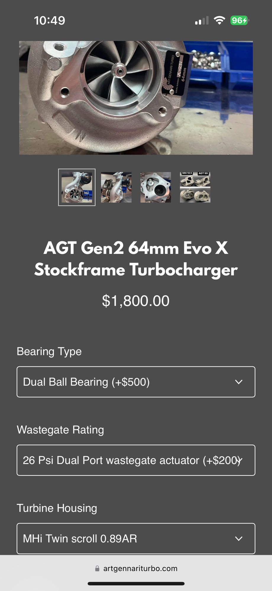

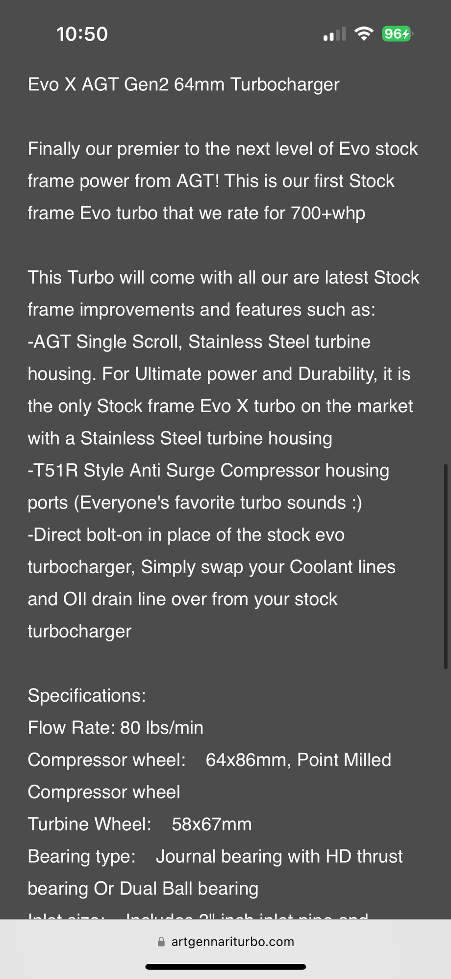

Hey I’m curious if getting ID1300 injectors and Walbro 450 fuel pump to go with a AGT 64mm gen 2 stock frame turbo setup would be over kill?
I will also be getting fuel rail and regulator etc to match pump and injectors.
(pic of turbo and specs included)
im aiming for 450-550whp and will be daily driving aswell, I also have all tephra mods applied and am wanting to put a daily drive lower tune on one map and another as a power map.

What fuel are you going to be using?
This will make a big difference in turbo sizing as well as fuel system sizing.

The injector size is fine for gas but if you're going to run E85 you may want a larger injector like a 1700cc.
For the pump I'd grab something that's a drop in size like an AEM 340 if you're going to run on gas, just to make life a bit more easier and simple. With the Walbro pump you will lose the filter between the pump and rail which means adding an aftermarket inline filter which complicates things and adds more expense. The AEM 340 should be enough pump for 550 as long as you don't need to turn up base pressure for the injectors too much. If you're going to run E85 then the 450 may be a better fit, but you're going to want to add a filter between the pump and rail.
I will still only be using pump gas
yeah I’ll only be running on pump gas,
thankyou heaps you shed a lot of light on that for me!
In that case, I would say what you have looks pretty good. I don't have experience with that turbo but spec wise it looks like it should make it.
