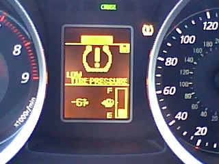

Originally Posted by salukidude
I mean wtf do people in the Northeast do; drive around with the tire pressure warning on all winter???
Yes.
Only kidding (not about the picture, it was really -6*.) After being on the road for a while the tires warmed up enough to turn the TPMS warning off.

Posts: 1,271
From: Denver, CO
+1
Here's a more clear shot :
