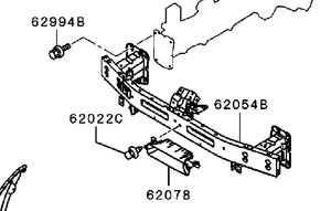

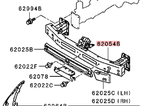

The US part number is 6400B096.
The JDM is 6400B095.
A german site (google it, .at domain) lists it at 77E. That's pretty cheap, but shipping might be killer.
USDM Support:
JDM Support:
I'm not seeing much difference in attachment other than the foam pieces.
What's funny to note is that the PNC is the same for both, but depending on your market you use in ASA it pulls up a different part number.
Attached Thumbnails Installing the JDM Crash Beam to mount a tow hook?-usdm_support.png   Installing the JDM Crash Beam to mount a tow hook?-jdm_support.png
USDM Support:
JDM Support:
wow, thanks so much for this! the pictures are really helpful!
what do you think of part 62078? numbers are same for both usdm and jdm, but then again the numbers are the same for the crash beam too. i'm thinking if the jdm beam is thinner, it's possible this part would be longer or something to compensate. ???
i think i see why they do not have the tow hook support on the usdm version. seems like the usdm version might be too thick, and having that welded piece might come too close to the bumper cover. dunno... maybe i guess.
otherwise, based on the pictures, there doesn't seem to be anything from the car that would use this beam as support, and the attachment to the frame looks about the same. might just work.

Don't forget that the Intercooler hanger mounts are attached to this, and they also serve for the bolt points for the "nose" of our cars.
Old Jan 22, 2010 | 04:03 PM
Golden's Avatar
Joined: Nov 2009
Posts: 1,456
From: Omaha, NE
Oh, and in the pictures, part 62078 is different. Look at the mounting holes in reference to the "flute" section of the part.
USDM is next to it / strait out
JDM is about mid way down.
