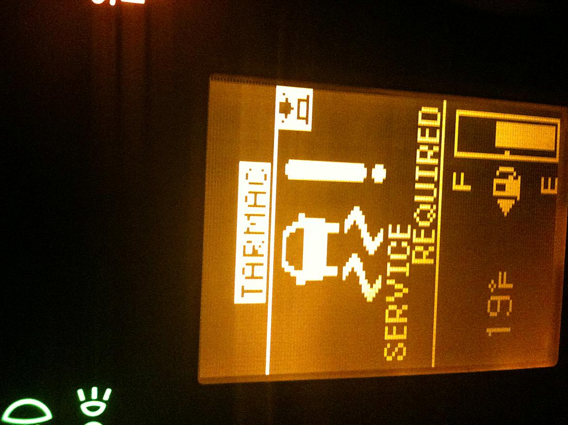

I gave my car wide open throttle last night and the "Service Required!" light came on. It always does this at WOT. I talked to AMS and was told it's a Over Boost issue or something wrong with the Diffs. I have a HKS SSQ BOV, AMS down pipe, test pipe, and single tip exhaust, Injen intake. Has anybody had this happen to them? What was it? Any ideas? I plan to go back to stock other then the down pipe and go to the dealer, Perhaps its time for a dyno tune?

i think you need a tune.....

You need a tune. The intake and exhaust parts are sucking in / letting out way too much air, let alone the cold temps that are outside this time of year. The car is programmed to only see a certain amount of air through the MAF, and you increased that with those parts, so it is causing an over boost situation. Go get a tune and see if that fixes things, it should. Don't take it to the dealership, because even if you change everything but the down pipe back to stock they will void the warranty and say it is the DP causing the issue (which it most likely is).
Get a tune, it should fix it, and you should see some power gains.

Are you getting a service engine soon light as well?
If so, its a really easy fix. The check engine light is actually causing the "service required". It is exacerbated by cold weather. Basically, when they tune your car, make sure you get the DTC disable. If you are getting a CEL, I'd lay money it is P1241.
Hope this helps, take care.

Well, I have a servise engine soon but the only code popping up as far I know( I checked it a month ago) is for the CO2 sensor(I don't have cat). I have read about disabling the DTC but then I have no traction control right? AMS should be able to fix all of this right? Because I was planning on a tune anyway and The only reason I would take it to the dealer was to make sure that there isnt a serious diff problem, and that is what im worried about. But Ive had these mods for 2 months now, why would the light come on in such a long time?

DTCs off will not touch your traction control. I had the exact same issue even with a tune in the cold. Basically, if you are throwing a P1241 code, that code is what is making the service required pop up. Mine could say Check, service required, and then ASC off, and I had to limp the car home or restart. If its not doing that, its a slightly different problem.
Whatever it is, DTCs off should help. It sounds easy to trigger. I definitely think you should book an appointment with AMS. Your car is not set to those mods, and it will flat out fly after the tune. A bonus is they can figure out what is causing the problem and disable it!

Actually, I didn't see that BOV. Just tell AMS to disable DTCs with the tune. 99% chance they can fix it and Mitsu won't have to even get involved.
