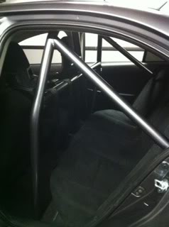

Old Dec 16, 2010 | 03:57 PM
JoeA's Avatar
iTrader: (44)
Joined: Apr 2005
Posts: 179
From: Citrus Heights, CA
Here are the pictures of my roll bar installed and the back seat is still in just for the looks, I took seat belts out and will never let anyone sit back there cause its unsafe. Like the picture above I went back and forth on weather or not to install this piece over a harness bar and choose this one thinking it would provide a bit more safty then just a harness bar. If I get more into tracking it i will probably do a weld in, but at this point I can still take this one out without dealer knowing to much if I trade in.
