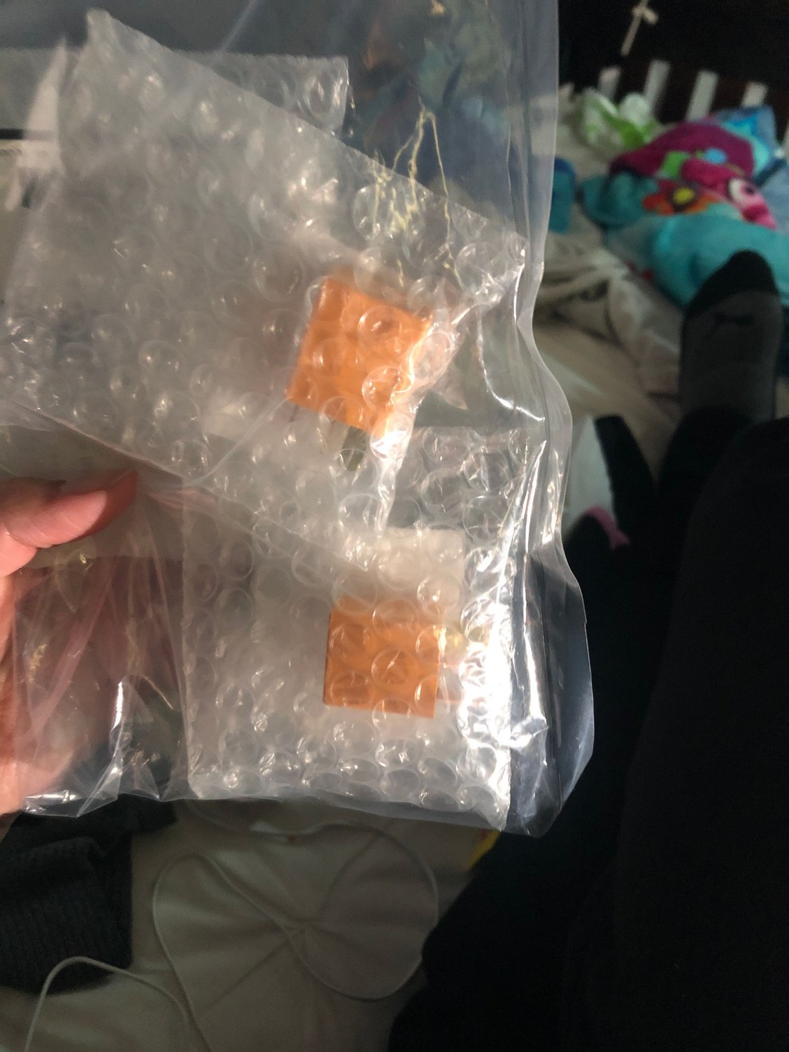

Blues relays
Hey I see everybody on here talking about replacing blue or green relays with the stock ones but I just got mine in from the dealership and they’re orange, I was wondering if those are good to install or if I should order the green or blue ones?
Old Feb 15, 2020 | 07:19 AM
llllBULLSEYE's Avatar
Joined: Aug 2018
Posts: 90
Likes: 10
From: NYC
orange and black Panasonic on the Final editions are the latest
so go ahead and install it.

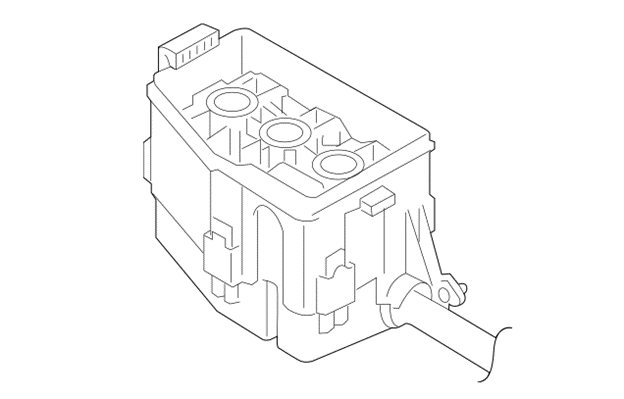

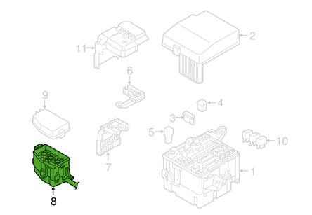

Old Jul 4, 2024 | 08:33 AM
Atlantwoine's Avatar
Joined: Jul 2024
Posts: 1
From: Conyers, GA
Angry How in the world does one remove these relays?!?
I have removed the Relay Box - Mitsubishi (8565A261) from the mount and taken off both upper and lower covers. How in the world do you remove the actual relays in the box? Trying to pull/force them out with tools only damaged relay shell. Is there some sort of locking mechanism or clip that I am not seeing that keeps those relays locked in place?
