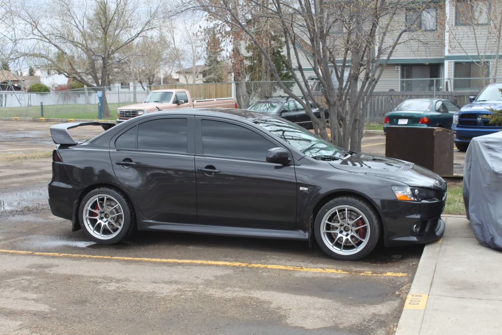

No im in the army so im always on the northend of the city. And yes, my mods are...
Ball Bearing FP Red, ported, hiflow oil feed line and 25psi wga
FIC 1100cc injectors
Walbro 255lph fuel pump
AEM Fuel Pressure Regulator kit
ETS 4" IC
AMS UICP
AMS LICP w/ TiAL QR bov
AMS CAI
AMS Widemouth DP
T1R Resinated TP
Tomei Expreme Exhaust
TWM short throw shift with cage and full bushing replacement
Perrin Rear Sway Bar
Perrin Rear Endlinks
AMR Coilovers
AMS SS Braided Brake lines
Motul RBF 600 brake fluid
PF01 Rims (18X9.5) with Falken RT 615k tires
SSP Undertray
GS 3port
DSG dual Pillar
AEM Digital Wideband/boost gauge
Clipse3GT Tuned on 94 Octane, 27psi (approx 423whp 382trq)
I burnt the clutch out with the launches and pulls during the tuning so on the way (should arrive next week)
ACT HD 6 puck clutch
ACT Streetlite Flywheel
AMS CMC kit
Your reaction time wont make your times change. You could sit there for 5mins and still run low 13's (although people would get pissed with you just sitting there) Do you have any mods? 13.4@104 is a good time, especially your trap speed. Bone stock i ran 13.5@100 with a 1.8 60'
This is my car...
