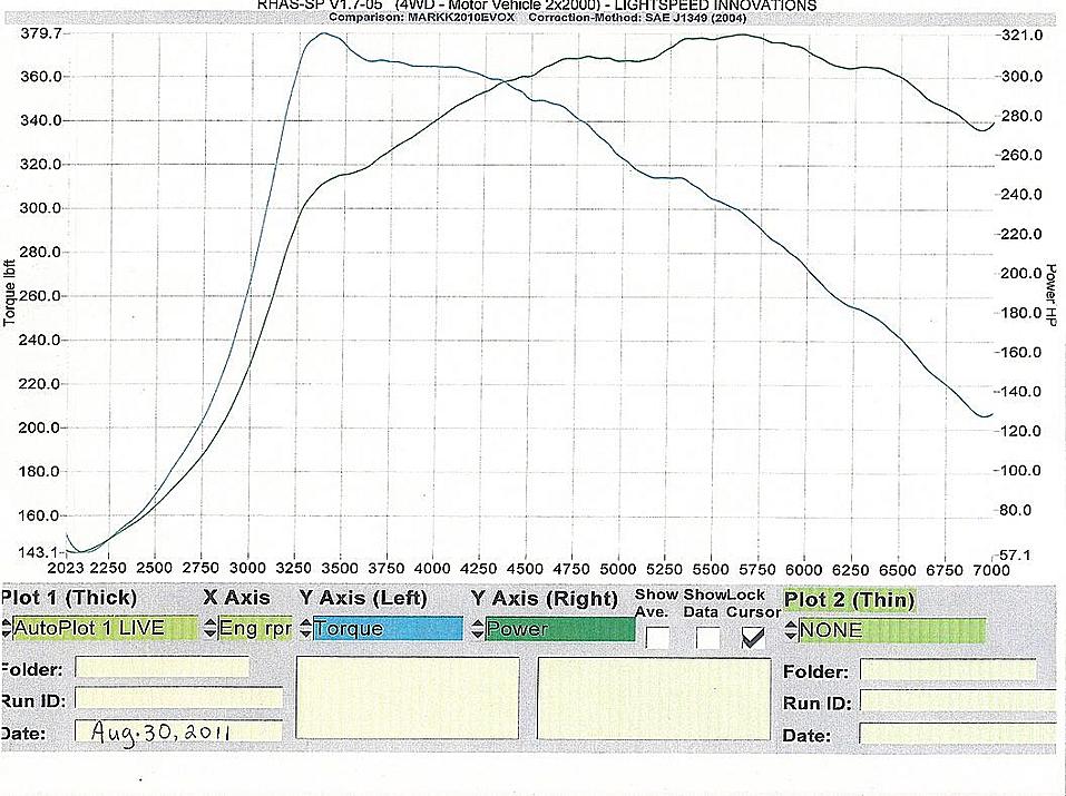

do you have a picture of the dyno graph. I'm not a fan of Cam's work. I think it would be better if you were making around 350hp and 350 trq. With those mods you can get more hp. the trq is the killer though and thats what you gotta keep an eye on. When do you get full boost?
As for your times, you need to get a 1.7 - 1.8 60'. If you learn how to launch it with the 2 step you can get a nice 60'. But you will need a clutch soon, haha.
Here is the copy of my last dyno.
Jesus... Max torque by 3200rpm. I highly recommend getting a different tune or at least get cam to either back the torque down or have it hit peak torque later in the rpm. Whats your afr?
@ wot I am approx 11.5

Well it might be safe since i dont know what the full tune looks like but hitting max torque that soon would be way past my comfort zone.

From: Edmonton
Ya. I am definitely wanting to try a different tune. I think I am gonna look into tuners in Calgary. I would consider an etune but i would need another wideband i think. I have an innovate wide band gauge & i don't recall seeing anywhere to plug in for data logging. I have been running this tune for almost a year & my previous tune For over a year & had the exact same curve. 377 awtq @ 3200 rpms, 305 awhp. That was on stock i/c & stock airbox.
The only one in Calgary is Sunny from Airboy tune, he's worse then Cam..lol. I'm going to get this out of the way, i am in no way bashing Sunny or Cam, im just relaying the info to what is avalible for us (Evo guys in Alberta)
If you check out the other forum, Cody (pounder) went to Sunny with his Ralliart EvoX swap. He said the tune was alright but it was knocking in a few places. He got a hold of Kris (Clipse3GT and did etuning), he got 50hp more, no knock and overall driveability improved. LIke wtf? he got more power, safer and DD driveability improved... Couple of othe people had similar expeirences with sunny like that.
As for the wideband and etuning. You shouldnt need another gauge. There should be a blue wire (at least on mine its blue) for logging coming off the back of your gauge...it might be a different color. You run that wire to a usb-serial port adaptor. You connect that wire to one of the pins, another ground wire to another pin and to a grounder spot. Then plug the usb part into the laptop. Its really easy to do and i installed the adaptor in another Evo owner within 40mins. PM if you are interested and i can give you more info.
