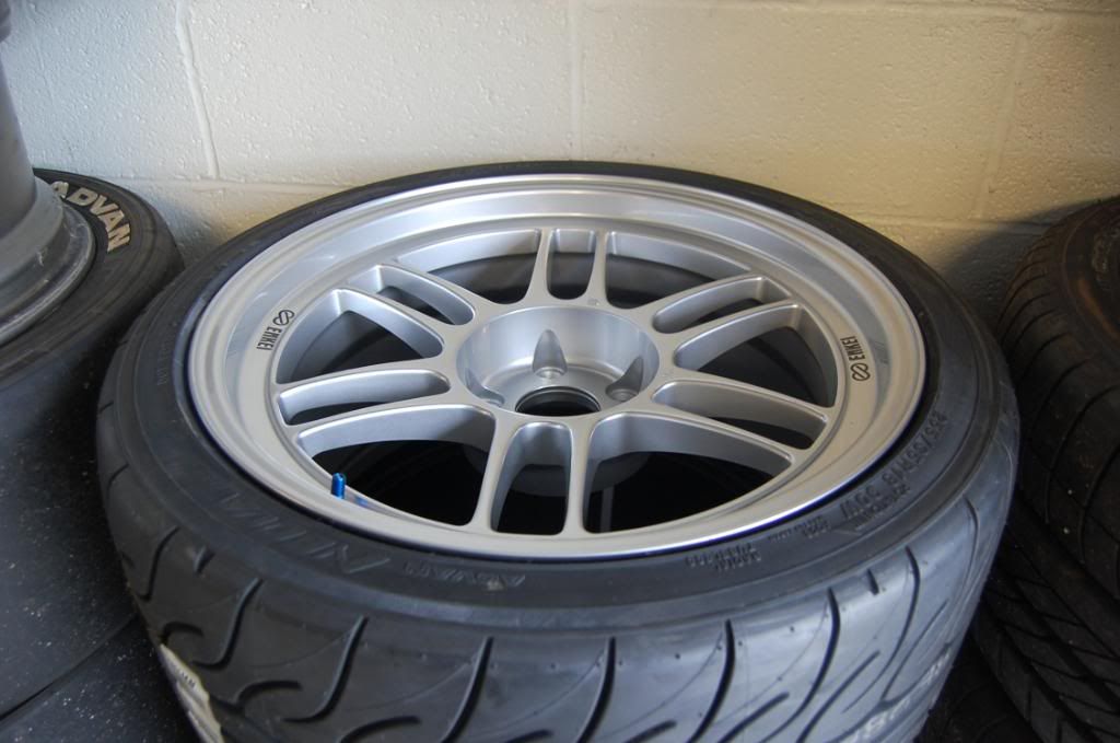

well, the turbine housing, manifold, and downpipe are still at swaintech! hopefully they will be back by the weekend!!!
the exedy stage 2 was installed, along with remachined factory flywheel and new TOB-

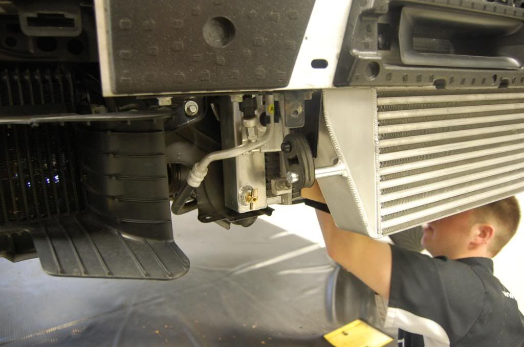

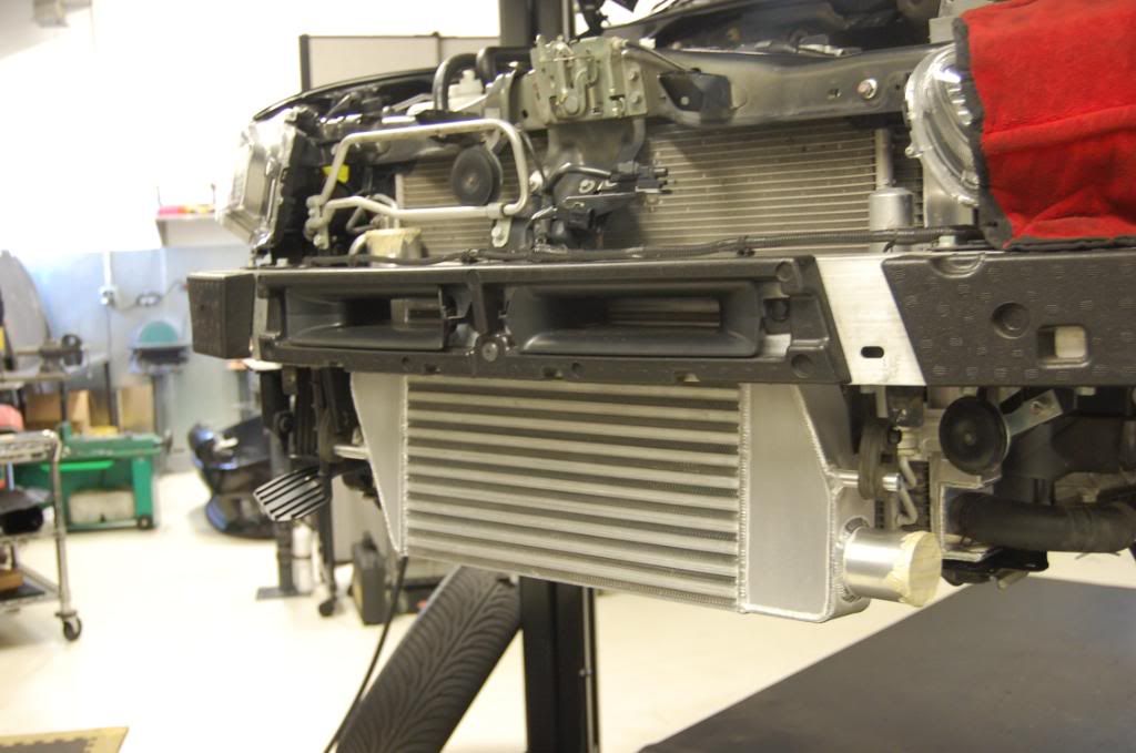

our CBRD Racing Radiator is in, along with our FMIC---

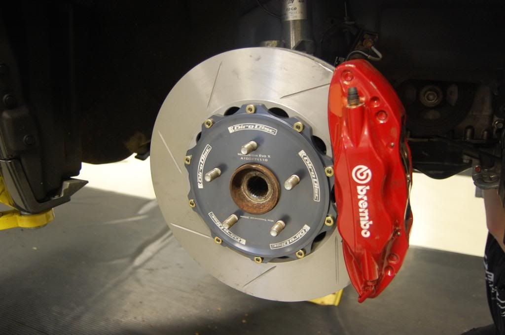

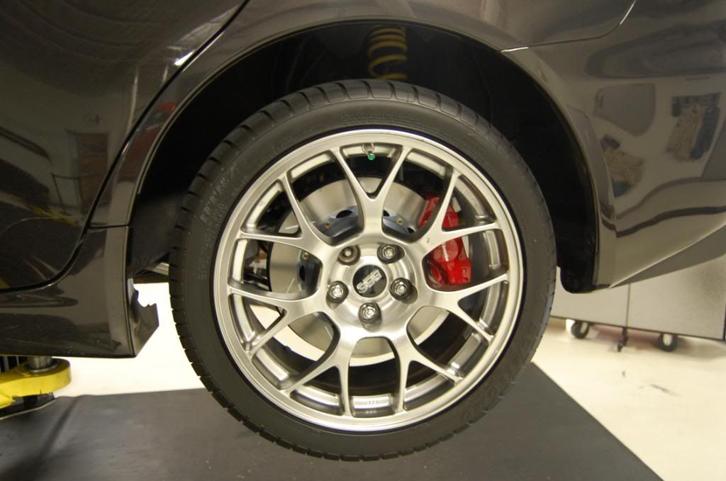

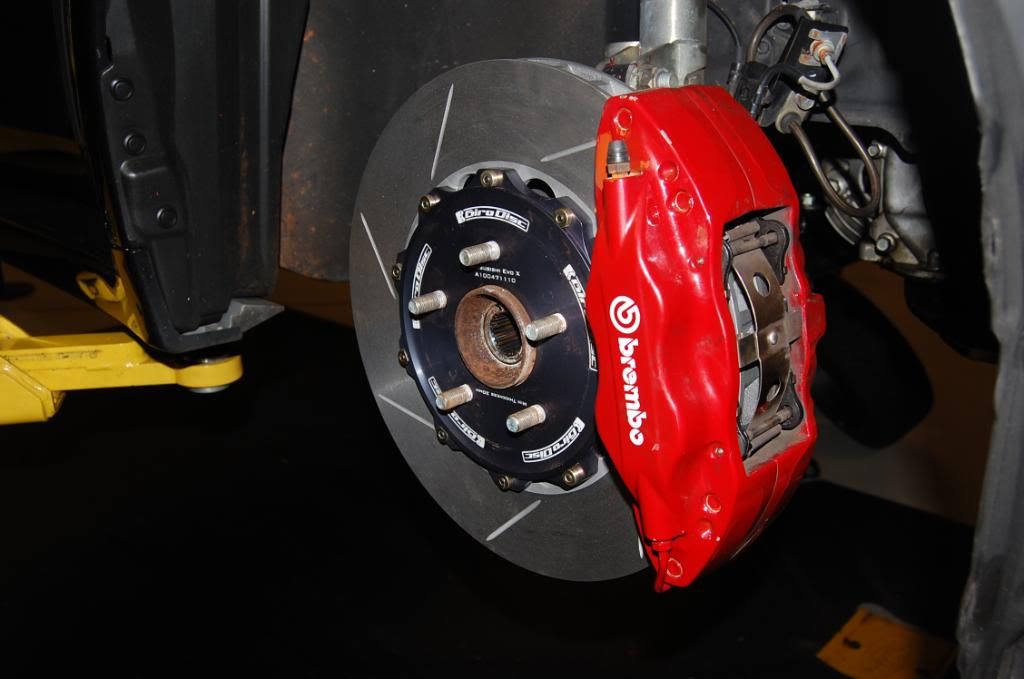

the Awesome Girodisc rotors are installed, pads in, needs to be bled-

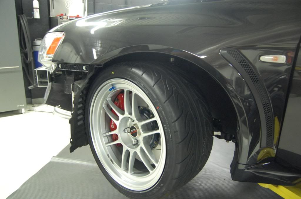

and we are balancing the RPF1 Enkeis with 255 AD08's as we speak-

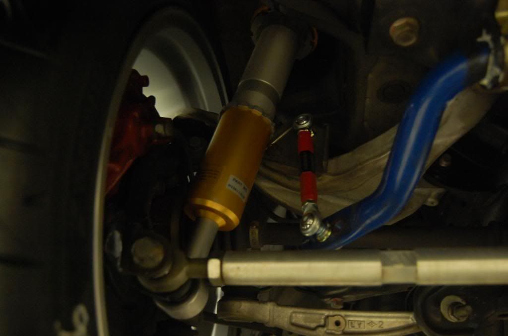

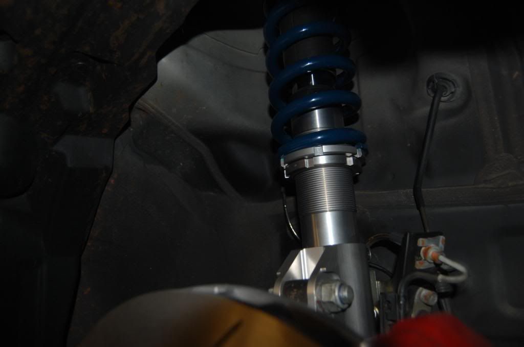

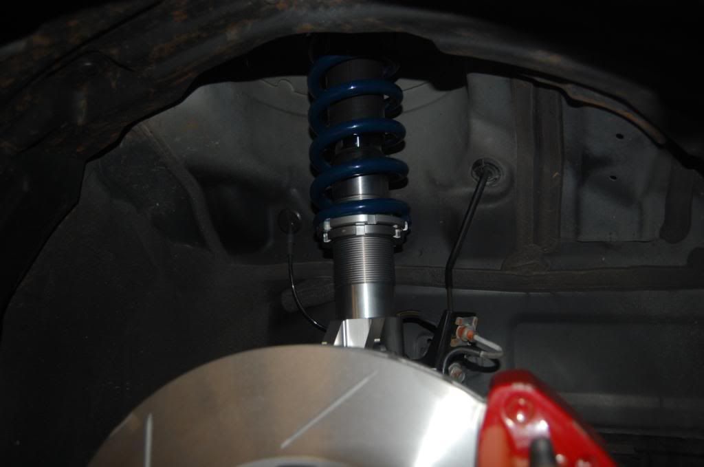

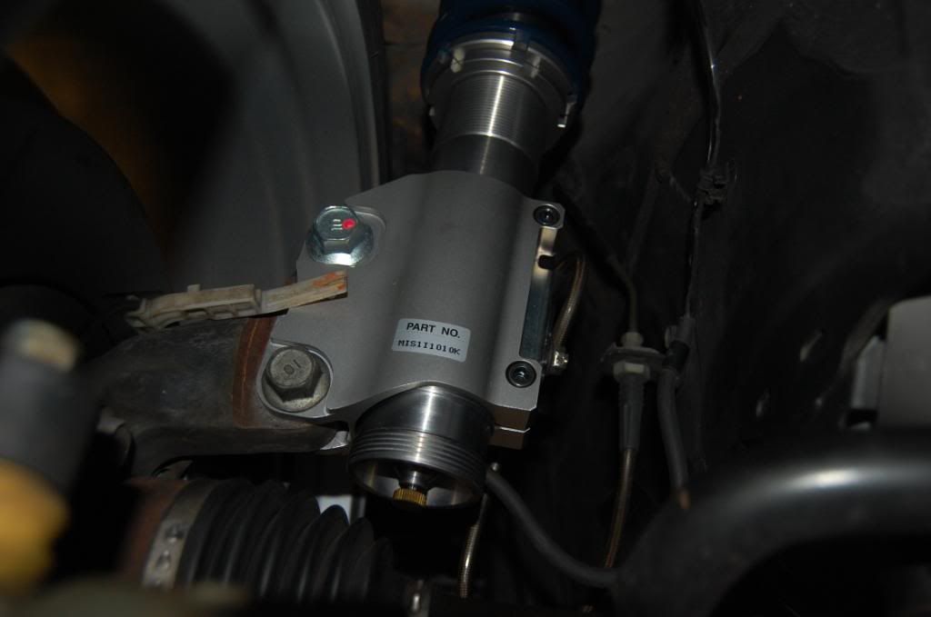

Richard made the decision (and I was glad he did) to switch from the KW's to the ohlins-
I feel (especially at Sebring) that the improved damping ability of the Ohlins will really show its superiority-
Here are some pics-
Spring Rates are 600 front/572 rear- car has a big rear bar- and we will use that and pre-load to get the handling to richards liking-
more pics of the swaintech parts when they come back!
Cheers
CB
CB

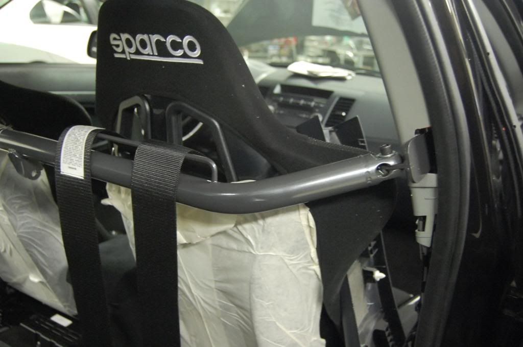

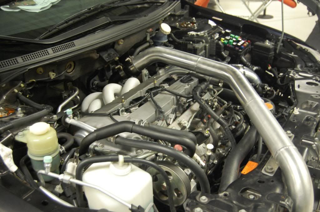

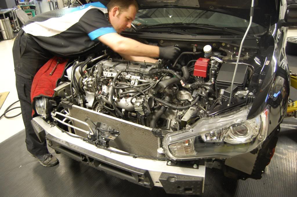

sorry everyone, we've been swamped...
cars from all over the country.. and lots of work/development--
richards car will be finished by next weekend.. so here are some more pics...
as of tonight.. the build covers..

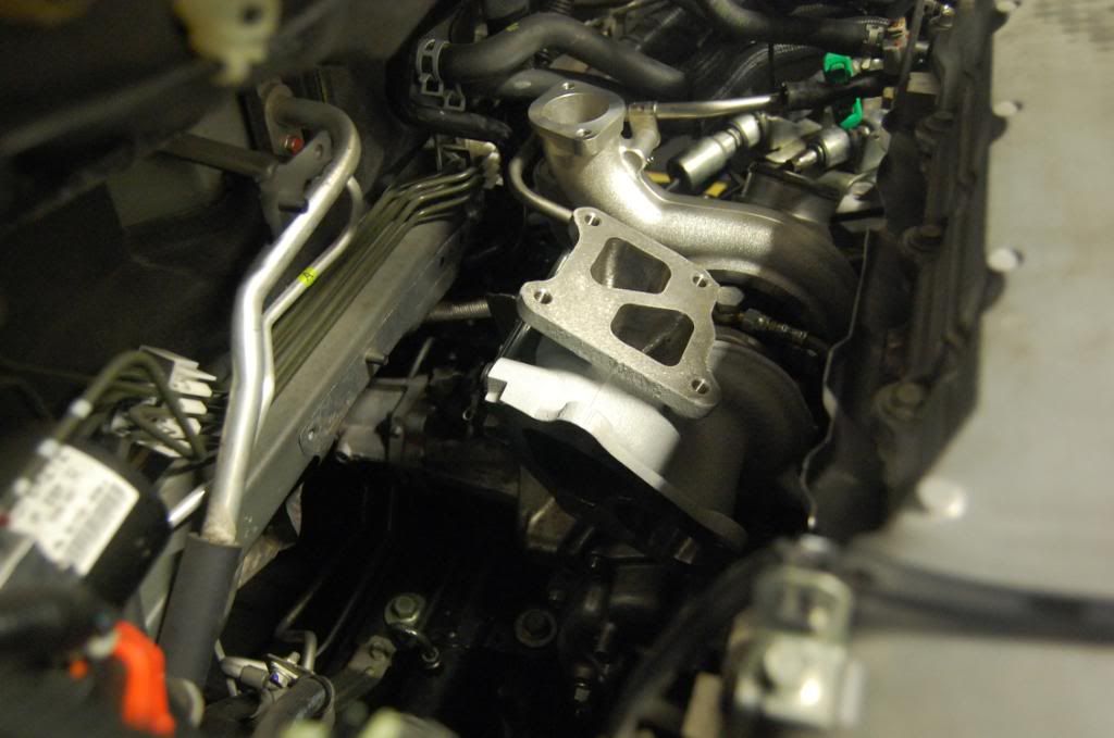

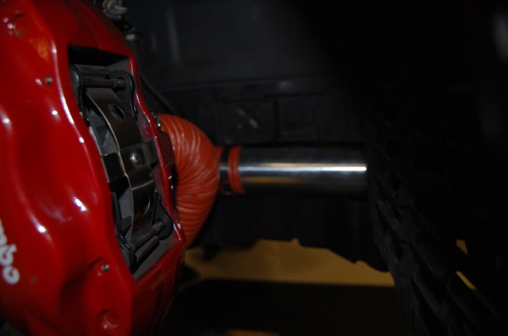

cbrd bbx lite (swain coated hotside)
cbrd fmic
cbrd radiator
cbrd hot charge pipe (2.5") cbrd cold charge pipe (2.75")
id 1000, 3 port pierburg
ohlins, cbrd spring rates, cobb rear bar, perrin drop links
girodisk 2 pce fr/rr, ss lines, pads, fluids
exedy stage 2, ams mc, ams clutch line

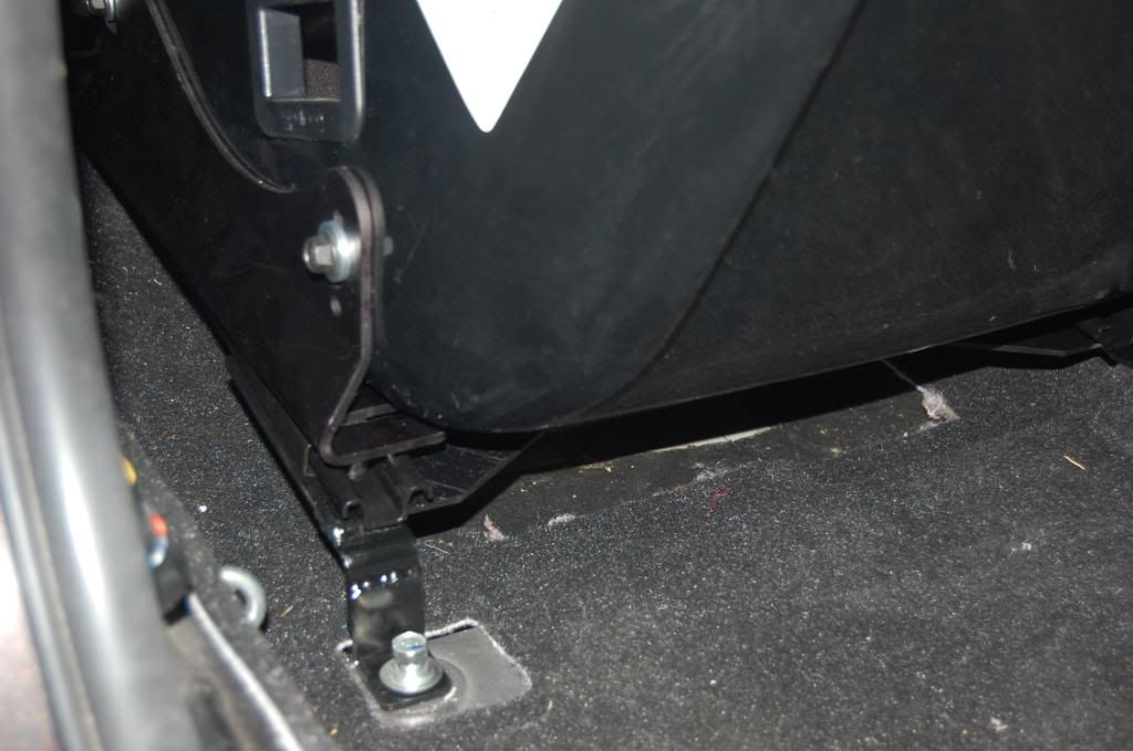

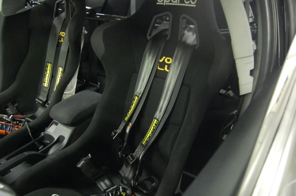

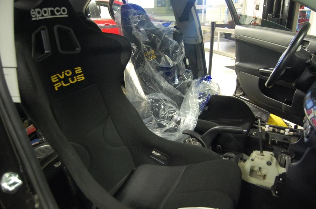

sparco evo 2 plus driver/pass, sparco bases (cbrd modified)
sparco sliders/bases (cbrd modified)... schroth 6 points (driver with dual hans)
and more... here are the pics..

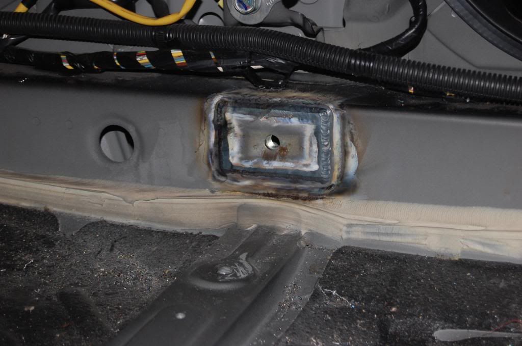

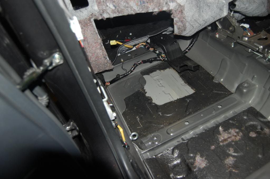

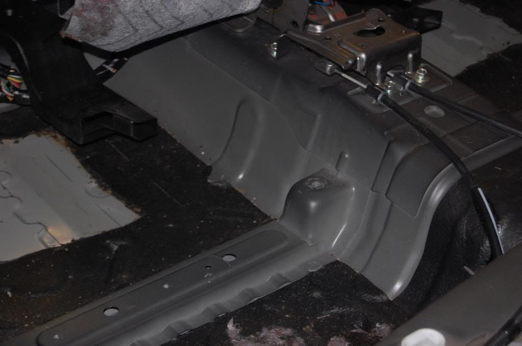

welding in harness mounts
bbx lite before manifold install

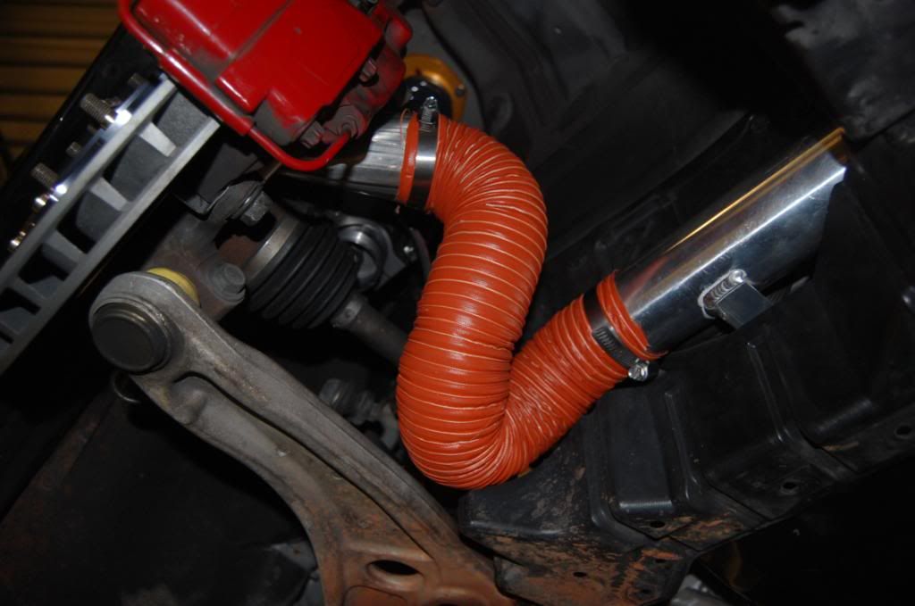

AMS ducting
ohlins with hyperco springs
MORE COMING

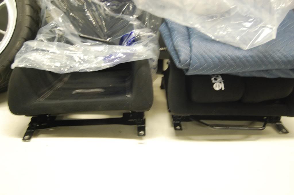

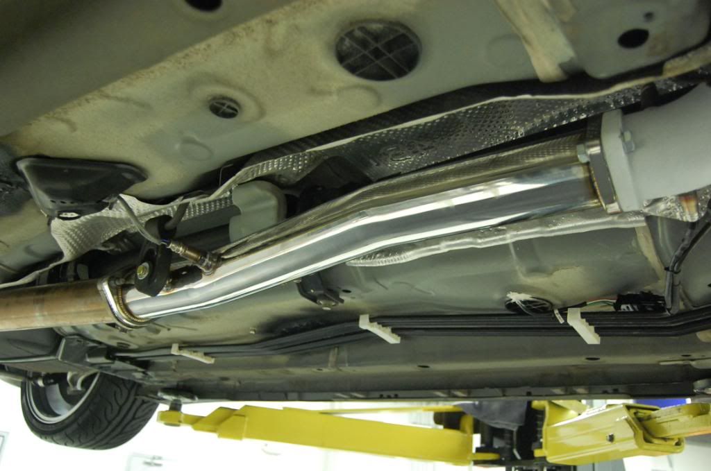

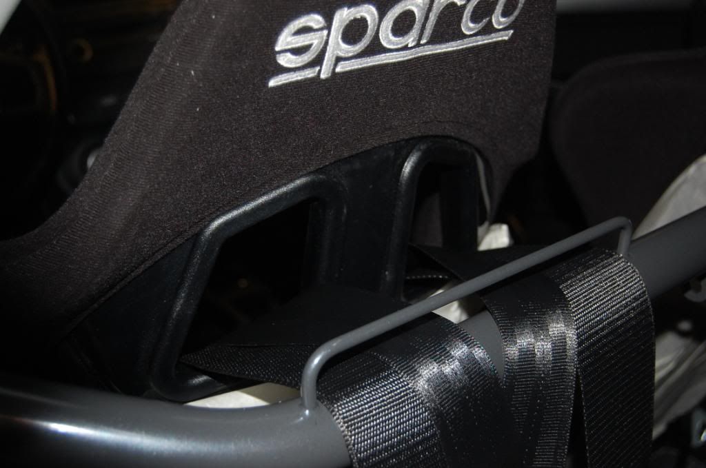

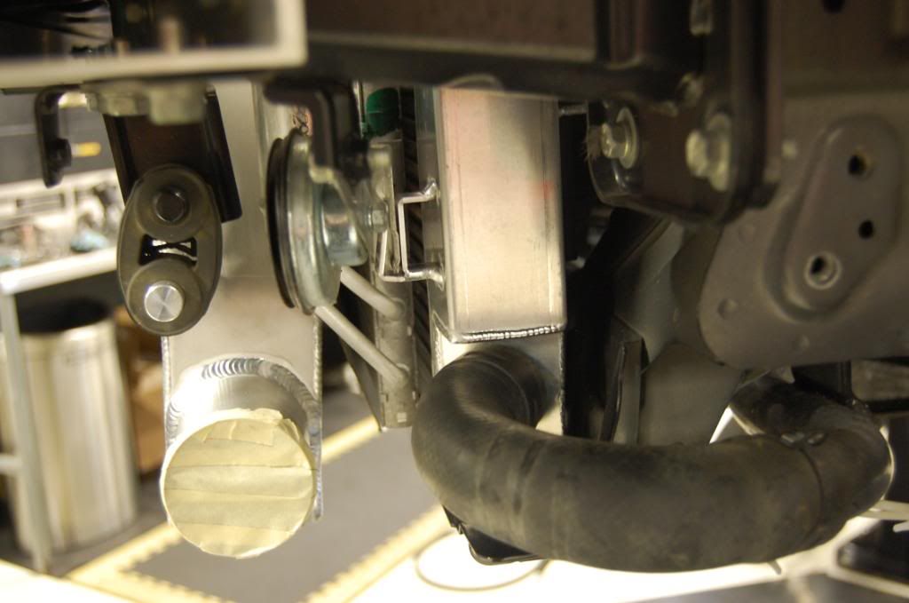

more detailed build pics of the harnesses, sets, and so on!!!
Perrin rear drop links... !!
Pretty pretty

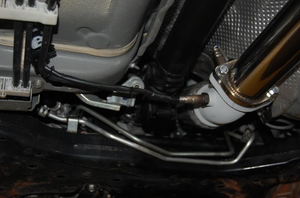

Swain and wideband...
test pipe...
before propper looping... hans Profi Y schroths..
keeping richard safe..
heat coatings and lots of cbrd piping
cb
