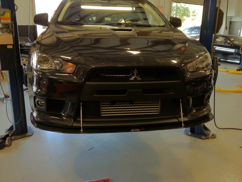

Titan Motorsports may have bolted it on for me. but I thought I'd showcase another car color with it installed. This girl is getting tuned today!
