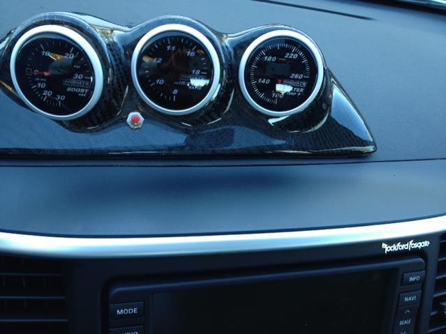

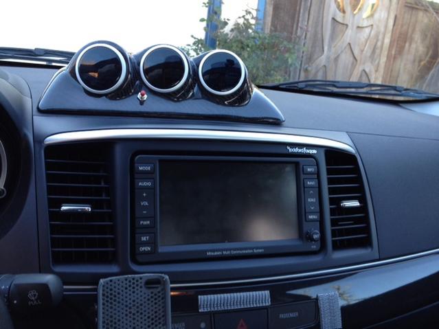

after a shop did the installation for some gauges I found that the navi in my MR is not function properly. Vehicle position is all messed up and it looks like some sort of sensor or signal is missing.
the shop is far and before I contact them, I'd like to know if it is something I can do to check / fix the issue.
the gauge pod is on top of mmcs system and yes they did take the system out to run wiring...

the gauge pod is installed right above mmcs unit. it's evo-r 3 gauge pod. could that be possibly blocking GPS signal? or mess up the sensor.Originally Posted by 07outty

do you guys think by moving the pod back or toward right should clear the gps sensor ??
if memory serves me right the gps antenna should be located on the right of the rightmost gauge, below it. pull the nav and see if its still there.

thanks. I'm moving the pod 1.5" toward front of the car. should be enough to clear that antenna I think. I need a few days to confirm this position is good and will post update pic.
after few days running with this, I believe it works. Although it's not perfect
conclusion is : it's not a good idea to have gauge pod on the dash if you have mmcs.
in my case, I plan to relocate the antenna to the front or under the gauge pod, well, whenever I have the time...
