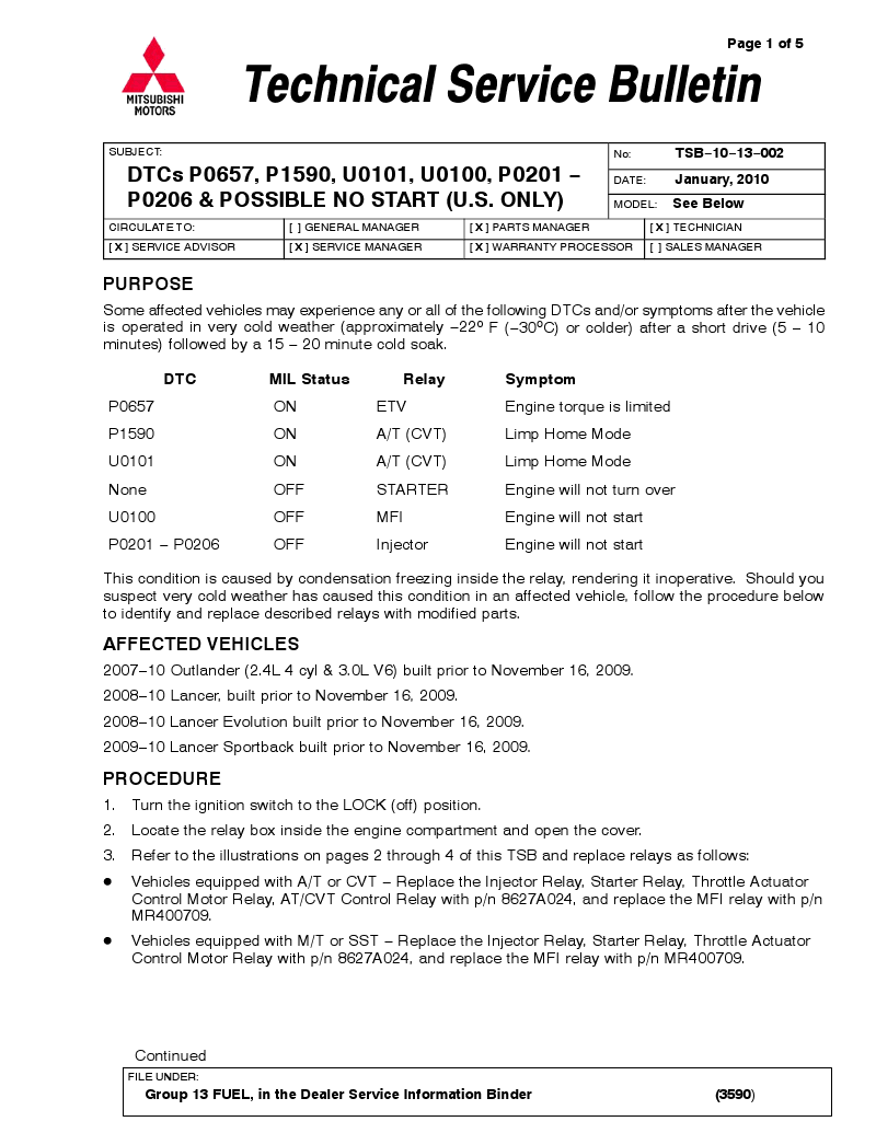

TSB for Relay Failure
Be aware of the condensation in your relay failure TSB.
Attached Thumbnails Everything electrical shut down while driving and now it won't start-tsb1.png
