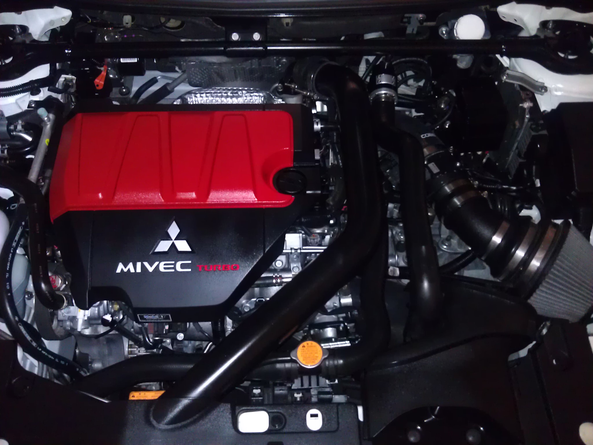

Hi was wondering if the Cobb inlet is longer then th stock one? I have one installed on my car already but I got my takeda intake shipped in.. but when I installed it nothing fits... in order for it to fit is have shove almost the entire pipe of the intake in filter... so I was wondering if the Cobb inlets a lil longer then the stock one..
And one more thing.. when I installed my intake and I start to boost the let off the gas there's a loud knock when the bov purges... is it normal? Or is it a failing bov? Thanks guys!

Kracka should chime in on this one.
He has the Cobb inlet + aFe intake which is the same as the takeda only with plastic tubing instead of metal and he got everything to fit. I believe he said he had to play with it but it fit and looks really good.

AFE is actually black powdercoated metal, not plastic (contrary to what their website says). The only actual difference between the AFE and Takeda (besides logos and stickers) is polished vs. powdercoated.
There are a lot of areas for adjustment, but everything does fit together very nicely and combined with the Cobb or Perrin turbo inlets it's my favorite intake setup available. Loosen everything up (all clamps on both the turbo inlet and intake) and slightly rotate each individual piece until it all lines up perfectly. The knocking noise is your BOV hitting the factory strut bar, trim about a 1/2" off the BOV recirculation tube on the turbo inlet with a razor blade (it cuts very easily).

I see.. cool thanks man! I mean I got it in but the polish tude all stuffed in the filter.. the reason I bought it was for the polished tube lol but I'll try adjusting things
By any chance do you have a pic of the set up? For reference?

Full size: http://www.dsmstyle.com/photopost/data/641/IMAG0497.jpg

Nice thanks dude big help
