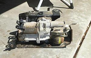

Update: My son's AYC pump is shot. Worst corrosion I have ever seen. Solenoids shot as well. Can't be rebuilt. Needs a new pump. We have the ACD kit and will have it rebuilt using it. We will also build a protective shield and coat the pump with anti corrosion paint. This, just after 2 years of use and about 23k miles. And, to think that Mitsubishi says the pump went out because of a "tune".

edit: here was my pump:
