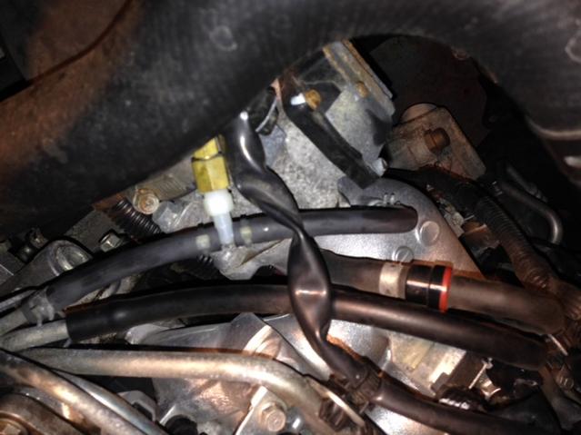

Heres a few pictures.
Attached Thumbnails New to Evos. Overboosting Issue!-photo-1.jpg   New to Evos. Overboosting Issue!-photo-2.jpg   New to Evos. Overboosting Issue!-photo-3.jpg   New to Evos. Overboosting Issue!-photo-4.jpg
Old Oct 24, 2013 | 11:53 AM
Teamlacalle's Avatar
Joined: Oct 2013
Posts: 26
From: Ohio
Pictures arent the greatest. But the boost gauge is hooked up to the throttle body where the brass connector is and that goes to the top of the bov. The other one with the check valve goes from throttle body to the selaniod. umm the second selanoid with 4 lines running the them. the back ones run to the bottom of the intake after the maf sensor. the other set goes to the wastegate i believe.
