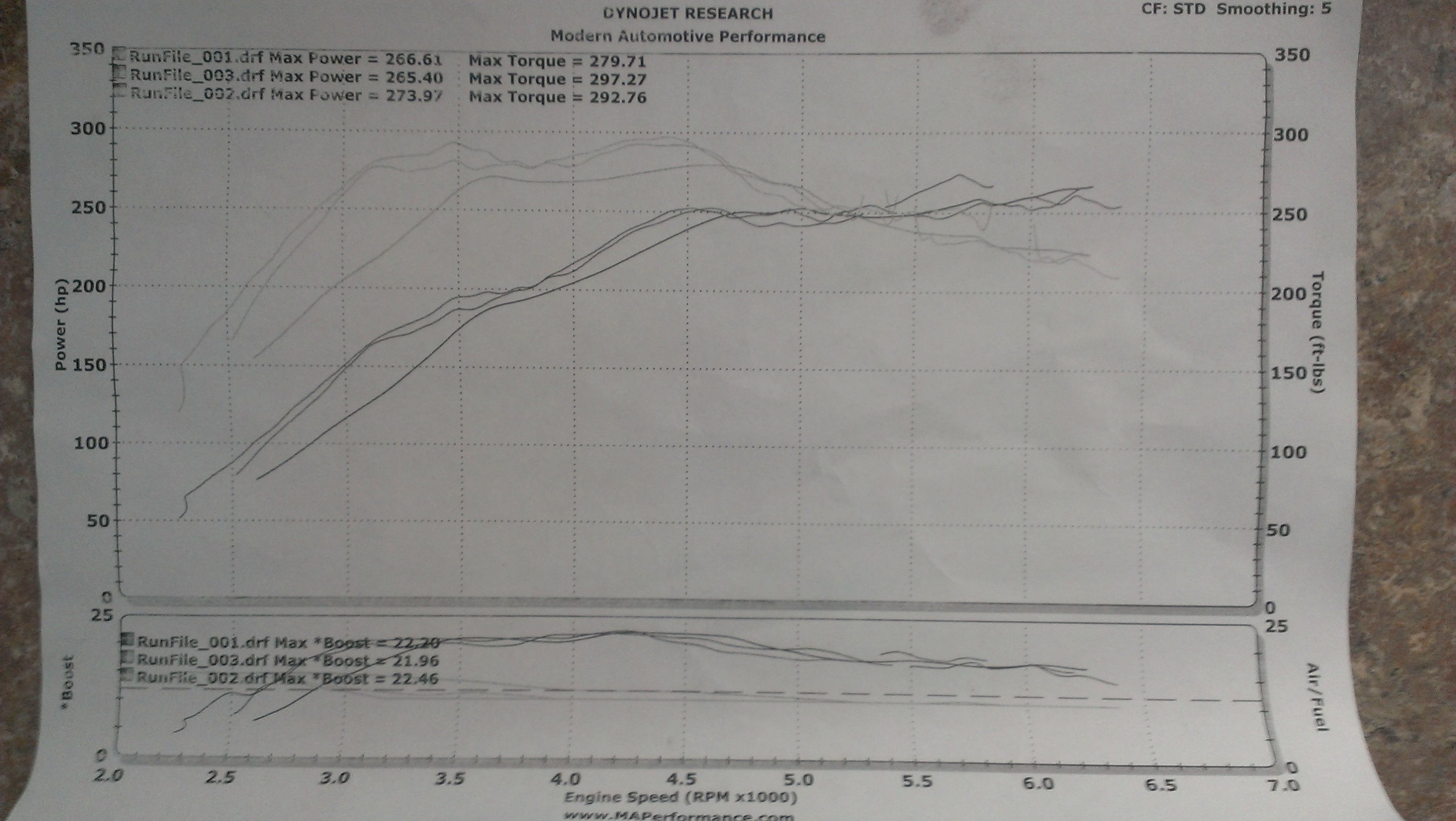

Stock baseline runs, no parts or tuning

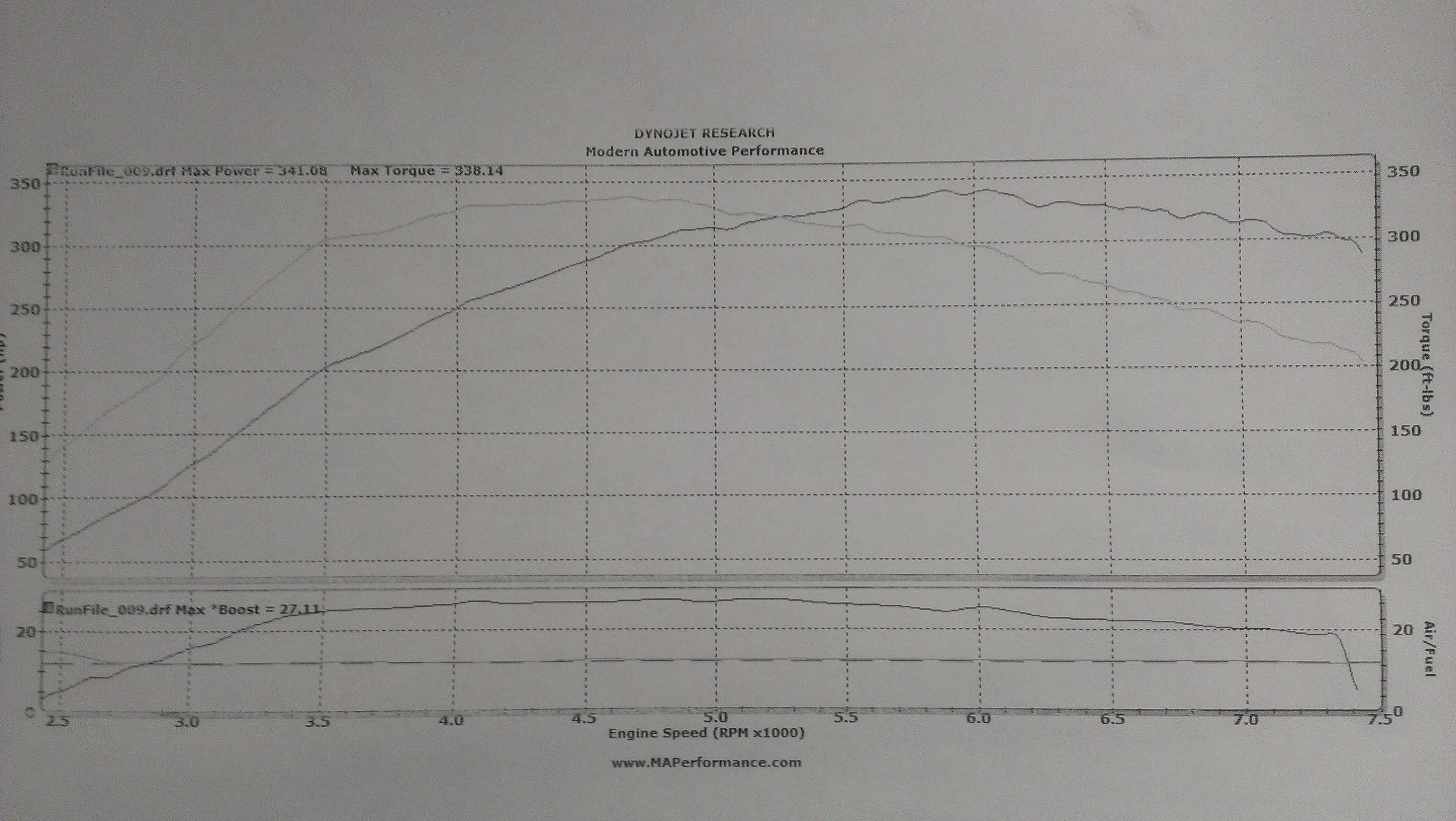

After parts and pro-tune
