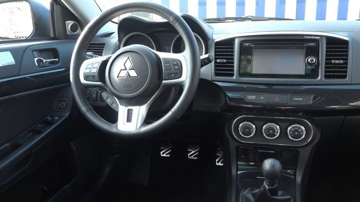

Hi everyone. My 15 GSR has just a big open space. Is it possible to buy those compartments dividers or doors.. whatever they may be called and install them? No idea what to search the forum for. Any help appreciated. Thank you!
Pic included..
http://s1.ibtimes.com/sites/www.ibti...x-interior.jpg

Yeah, you can buy them. The parts aren't cheap so you'd be better off finding someone parting a car. The MR and the Ralliarts with the touring pack had these bits. I also know that up until recently the parts were all the silver carbon-look so finding the piano black bits to match your '15 might be even tougher. Good luck!
1 73108 1 8010A189XA PANEL,INSTRUMENT,LWR CTR BLACK
2 73600 1 8010A167XA BOX,INSTRUMENT PANEL CONSOLE BLACK
3 73600 1 8040A032XA BOX,INSTRUMENT PANEL CONSOLE BLACK
4 24054 1 8015A094XA PANEL,GEARSHIFT LEVER BLACK
5 73062 1 8011A730HA GARNISH,INSTRUMENT PANEL,CTR SILVER
6 73167 1 8040A029 PLUG,INSTRUMENT PANEL CONSOLE
7 74114 1 8041A040XA HOLDER,FLOOR CONSOLE BOX CUP BLACK

Nice!!! Thank you!!! I didn't know it was an MR and Ralliart only item. Appreciate the info!
