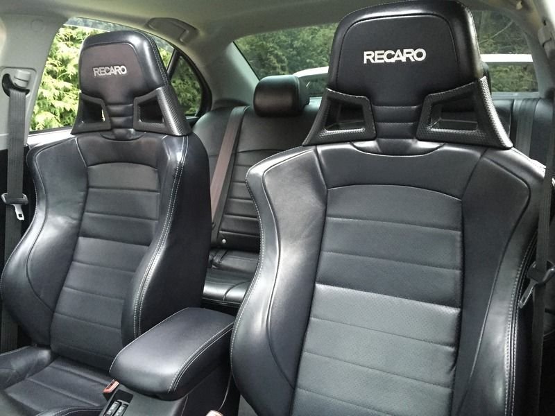

I just did this a few weeks ago on my '15 MR-T not Final Edition, but same steps involved.
You use your original passenger seat weight sensors, module and both belt buckles. And a lot of dealerships can't/won't re-calibrate the sensors or modules as they are VIN coded.
Make sure you leave your negative battery cable disconnected while you have the seat wiring unplugged.
This whole lower bracket that holds the weight sensors and module can be directly swapped over from your original seats to the Recaros.
Easiest way is to just leave everything hooked up as so and simply swap the whole assembly over.
here are pics of mine... when thats all done, you should have this and no airbag lights!
