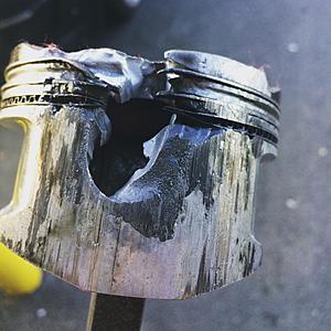

Made 384/391 DMT Tuned... NO e85!
2 days after tuning thats what happened.
510hp & 400tq @30lbs on pump.
Now getting sleeves and ton more stuff done.. Hope to have her back up and running by July.
Holy **** lol, 30lbs of boost? The scraping on the side shows it obviously lost oil at some point, and detonation could have caused this. If he's running aggressive tunes, he might be pushing on the lean side of the AFR.
Pre-ignition or detonation could have caused the heat that melted it though. Or it could have broke something off the piston/cylinder wall and that piece scraping the wall created additional heat.
But I would go with lack of oil and pre-ignition/detonation from a super lean mixture.
Numbers are just numbers, you are not making more than 350 whp DJ or ~330 MD on a proper reading dyno.... the NO e85 tagline leads me to think you really believe you cracked 380 on stock turbo on pump which is just stupid. Also DMT tuning blew up one of the local guys down here, I would watch that tune. If there are better options for tuners why risk it?

Ok, DMT Tuning built and tuned my car.
Bottom End:
Bored .20 over, hot tanked, honed, and decked.
CP pistons/ Manley IBeam turbo tuff rods/ kings rod & main bearings/ stock main studs/ stock crank.
Top End:
Decked/ valve job/ GSC beehive kit (springs & retainers)/ new valve stem seals & caps/ buckets etc.
ARP head studs, new OEM mitsu head gasket. Only thing head doesn't have is cams (Stock)
Fuel: Walbro 450/ FIC 1100cc injectors (Stock fuel rail, fpr & fuel lines)
ACT 6puck
Upgraded FP turbo to 25g w/ new exh housing, custom billet compressor wheel, ported etc.
Full bolt ons, wastegate, bov, piping and so on.
New timing chain, plugs, fluids etc. etc. etc.
I had CFT pull my motor & drop it back in, as Danny was too busy to do it. And in return i had to come out of pocket $600!!!! For **** that CFT broke and wouldn't do anything about even after ***** and *****ing to Rolo and the ****ty as tech Travis. They broke my Exh mivec solenoid $200, broke my axle getting it out $200, stripped oil cooler threads to block had to redo with -an fittings & also completely destroyed my shifter cable/linkage which was another $200.
So Danny, disassembled & re-assembled my motor after CFT pulled it.
Once that was done, CFT dropped it back in.
Again, ton of **** missing, loose etc. etc. Danny said he would do a full inspection of the car top to bottom after they finished installing the motor.
Motor was in place and I took it home with a ****ed up linkage etc. Kept it at the house and told Danny that **** wasn't right. On top of the linkage the car made some ticking which with our cars are fairly normal to a point. This issue was odd though.
ONLY between 2-3k it would make the noise then it would disappear. So Danny came by saw broken linkage, took a look at the noise and said it sounded normal but just odd that it would only kick on between 2k- 3k then go away.
So we had my valves relashed, had a new cam cap replaced, had just put in new mivec solenoid.
Still made the noise, i said should we send the head off to Mazworx to be flow tested etc. he said no.
Instead he got on his laptop and zeroed out all the values for mivec & the noise went away. He said that i would only lose maybe 5hp and it will be perfectly fine.....
Then i had to replace the shifter cable/ linkage myself and took the car to Danny's after he confirmed that it would be safe to drive.
He had the car at his house because i wanted a full inspection and make sure things were right.
I met him at his house and we did some street tuning. Verified i had a boost issue which was resolved by upgrading my wastegate.
He drove the car from his house and met me at CFT the next day for Dyno tuning.
So from the time the car was built til i got on the dyno was about 1 week.
Car got dynoed by him on Saturday, and made 510hp & 400tq @ 30psi on pump gas.
He said I was 100% ready to go!
Sunday (my birthday) car drove ok as we took it out to dinner & even the wife drove it home.
Come Monday i go to work then out for lunch. During my lunch break did a 2nd gear pull starting around 4-5k hit 7800rpm then hit it in 3rd, which didnt even make it to 7k before popping and throwing so much smoke that nobody could see down the highway..
Had Danny come take a look at everything and his assumption of what happened was a bad fuel pump relay..? The one i had was the new blew one.. Could have been lots of things.. idk.
Also, dont remember seeing any flashing check engine lights, afr's from what i saw were ok around 11.4-/7 during pull..
ONLY 2 DAYS after tuning it blew up!!!
Mind you, this was MY 2nd pull since i got it back... All the pulls on the car were from Danny on the Dyno and some street tuning.
And im now currently at PRS. They have pulled the motor and disassembled it.
Found TONS of things missing such as hose clamps, bolts, coolant hose to turbo, lose trans bolts and others. forgot to check the timing as we were excited to see what the extent of the damage was... So yeah wish i did..
Now getting sleeved, upgrading entire fuel system and basically bypassing the fuel pump relay and hard wiring the fuel pump with complete new fuel lines/filter, fuel rail, fpr etc.
New oil cooler, oil pump etc. etc.
And PRS backs up their work! Even going to warranty this motor for me 100% for min of 1 year.
I should be getting a sheet of everything they found wrong with the car.
Also haven't checked the tune yet which they will be doing soon.
Will update once i find out more.
But for now, yeah just disappointed..
