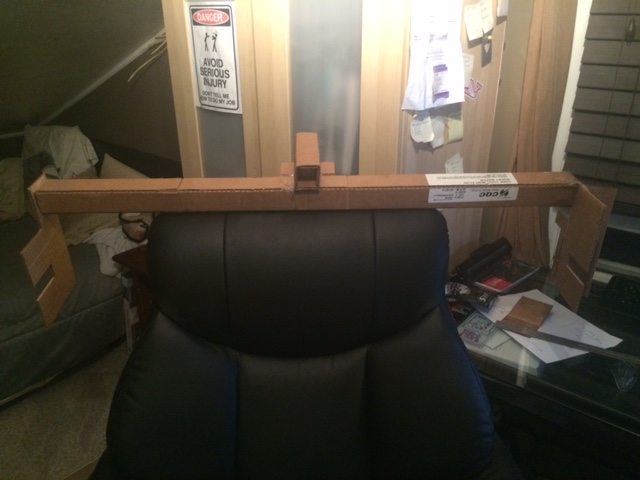

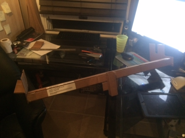

Day1:
Hitches for the Evo X. Using for bike rack and small trailers to hold tires and race gas. If anyone is interested in the project let me know. I will update with photos of 3D modeling I am doing. Been looking for this for a long while and no one has them. I have a custom steel fabricators to work with. I will be confirming all the measurements tomorrow. Hitch will be down facing and fully hidden when not in use. Custom mounting to rear hold down hook areas and no cutting of the rear diffuser will be needed. Also trying to make it work with OEM mufflers.
Thanks guys. This will be a Class I hitch - 200lbs tongue weight and 2,000lbs tow.
Day2:
It continues, first mock-up and dimensions taken. A lot has changed in order to keep the passenger side hold down that supports the ayc pump. Had to accurately measure and model the main frame and existing hole locations. I'll have to make this in to a mock-up and test fitment.
Day3: Stress Testing see attached link - https://lendlease.sharefile.com/shar...fd1a?_k=wpi7g3
Day4: Okay guys, just finished my specific order for everything but the curt vertical adapter which runs about $50-$60 bucks. The total amount of material with some extra for error is $164.12 using A-36 Raw Steel. I called the company and if I order enough material at one time can get a "better" deal. Everything is 3/16" steel except the cross bar which I beefed up to 1/4" for a safety factor. Some of the steel I bought earlier in the week was not the correct size unsure emoticon.
Stay Tuned!!!
Attached Thumbnails Evo X Hitch - Project-beginning-evo-x-hitch.jpg   Evo X Hitch - Project-beginning-evo-x-hitch2.jpg   Evo X Hitch - Project-beginning-evo-x-hitch3.jpg   Evo X Hitch - Project-beginning-evo-x-hitch4.jpg   Evo X Hitch - Project-beginning-evo-x-hitch5.jpg
Evo X Hitch - Project-beginning-evo-x-hitch6.jpg   Evo X Hitch - Project-beginning-evo-x-hitch8.jpg   Evo X Hitch - Project-mock-up2-1.png   Evo X Hitch - Project-mock-up2.png   Evo X Hitch - Project-beginning-evo-x-hitch11.jpg
