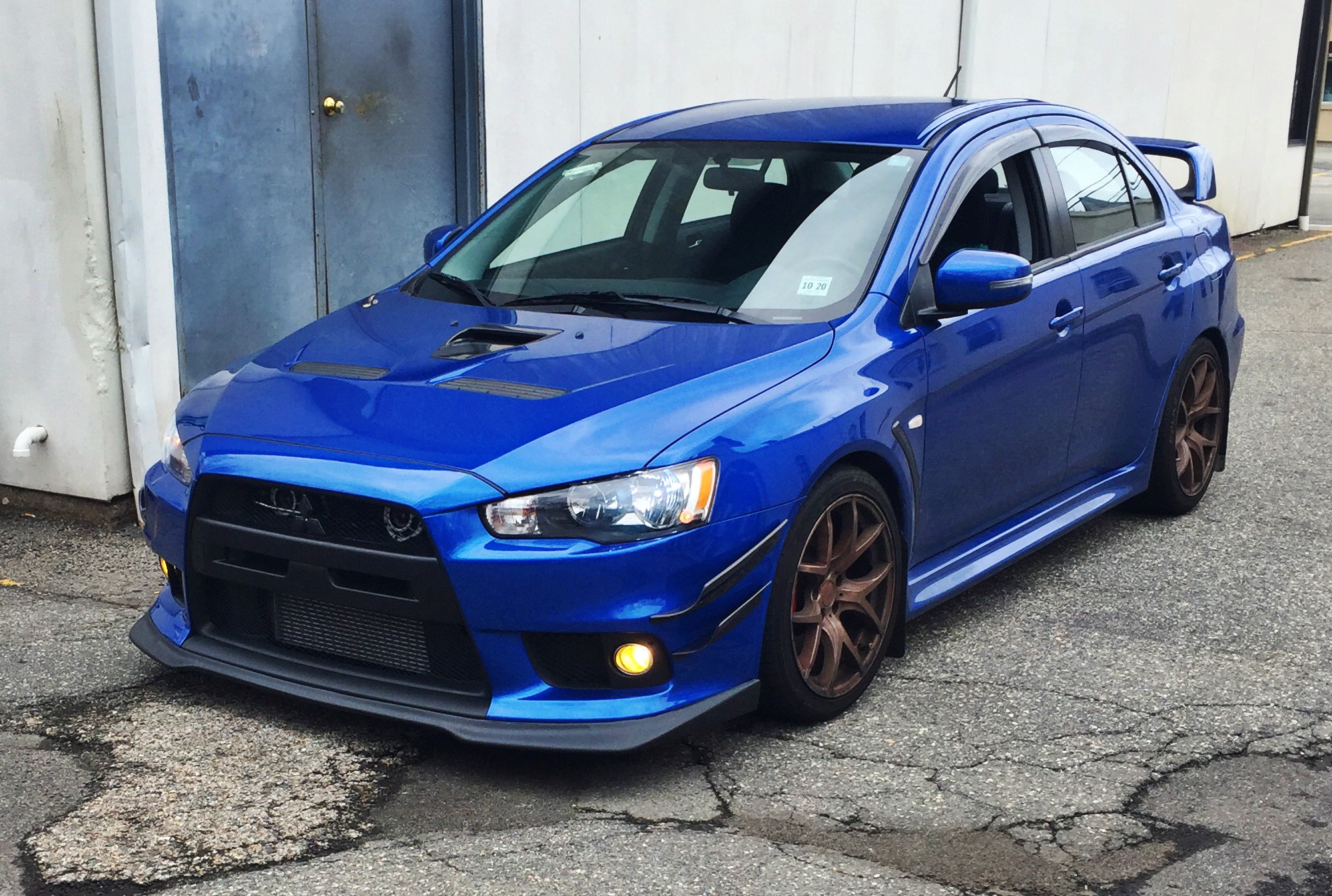

I have 18x9.5 +22 with 265/35 dropped on h+r springs I rub a little on full lock and I rolled the rear just to be safe. But all around rides great I know people running your set up with no significant problem. Car looks good congrats

LOL...with that wheel gap there shouldn't have been any fitment issues...Was the shop Discount Tire? I had those high school kids tell me my RPF1s wouldn't fit. I had to tell them to put them on anyway and I would "accept the risk", turned out I was right and they fit without rubbing at all. Now I have a 25mm spacer on them and with some rolling/pulling they still fit without rub. Shops that don't know anything about your car or the research you've done to make sure they'll fit just don't get it sometimes. I'm about to go to a set of 19x10 +22 RPF1s. Going to just get the tires put on and put the wheels/tires on myself. I've got rolled/pulled fenders and coilovers so I can adjust as needed.
