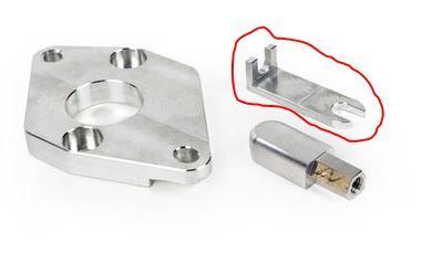

My car has the MAP Clutch Master Cylinder upgrade.
While driving yesterday, I stepped on the clutch and the pedal droped to the floor and the L bracket fell down. I pulled over and pulled the pedal up, and now its functioning correctly, for the most part. When I step on the clutch now it feels as if metal is rubbing on metal as the pedal is being depressed. Also the pedal has a lot more play.
The end of my L bracket broke off, and I cannot seem to find where it broke off from, or where a replacement bracket would go.
Any help would be appreciated. Thanks.

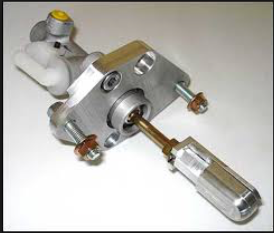

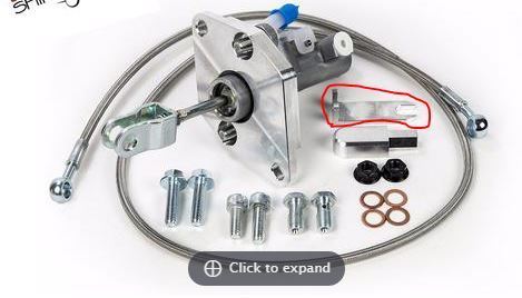

That bracket is what keeps the the ball in place. So it would look like this.
Old Sep 17, 2016 | 04:32 AM
t3am 83rd's Avatar
Joined: Mar 2011
Posts: 41
From: Earth
Thanks man, makes more sense now. I ordered a replacement from Magnus Fabrications.

Make sure you put some lithium grease or something in that cup looking thing. It just makes it smoother and it'll keep it from squeaking.
