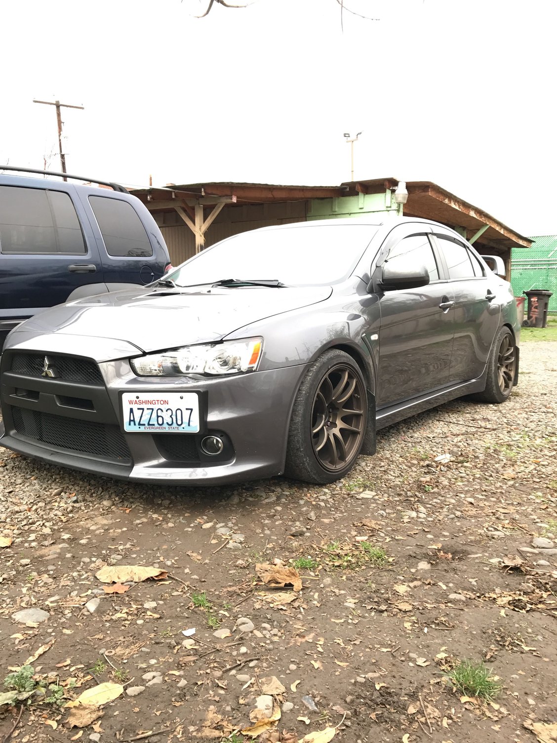

Thanks guys yeah im not trying to gun it low rpms in high gears @@ but thank you. What i meant was when i would be in 3rd 4th or 5th the acceleration would slip in the rpms. If i were try to push the pedal "through the radiator" gain speed before redline it would slip. im to far for RRE I have to go english racing im in WA and in that part to check with them and redo the tune i need the name of the 2nd owner of the car who had all the work done to it all i know is his first name was David and i need his last name and grey evo x on work emotions there was a socalevos sticker on it im the 4th owner 3rd owner Cody couldnt find any of the old papar work with Davids full name.
