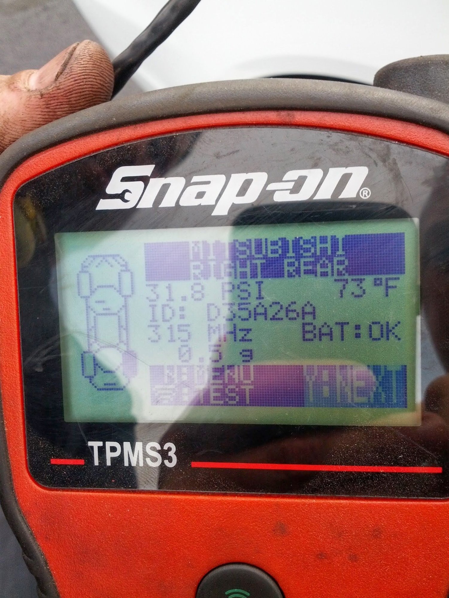

My RA and my Evo both say "TPMS Service Required" when a sensor battery is low/dead and "Low Tire Pressure" when it reads low. It's possible a sensor is reporting incorrectly.
Go to a tire store that has a decent TPMS tool. They can check each sensor and what pressure it's reporting. You can then check the sensor reading against an actual tire gauge and see if there's a difference.
