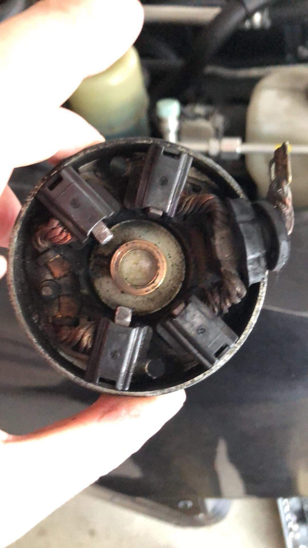

Old Feb 1, 2019 | 10:28 AM
Jorge86's Avatar
Joined: Feb 2015
Posts: 10
From: Clarksville, TN
Originally Posted by WillD_EvoX
Did you do a fuel test ad see if your getting fuel?
I think my starter is bad and two of the four prongs not fully out. Its not making contact with the starter solenoid
Old Feb 1, 2019 | 10:35 AM
Jp7's Avatar
Jp7
Joined: Mar 2007
Posts: 1,737
Likes: 112
From: Midwest USA
good find you can rebuild that starter and it will work perfect
