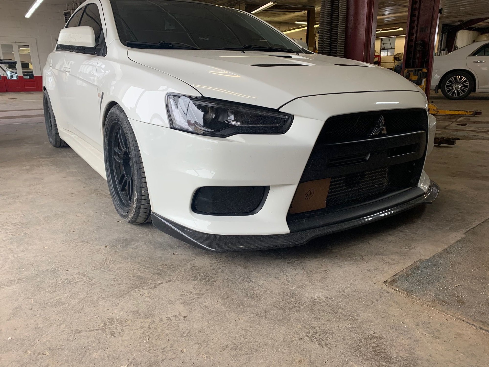

My oil is too dang cold. I've been driving in temps around 15F at times, and can't get the oil over 120F without going into boost, which I'm VERY hesitant too with such cold oil.
I've fabricated small blocking plates for the right side fender inlet, as well as the first 1/3rd of the front mesh where some air goes into the oil cooler. I've seen little change from these modifications.
Where does everyone sit on the temperature range of oil? In Florida, I could usually hold a steady 160F at highway speeds, 145F around town. I've never gotten it over 180F.
Is there anything I can do to keep oil temps up in the winter? I believe I have blocked off about all of the air going to the oil cooler.
Oil cooler fender air blocker, and front bumper blocker.
The fender one I cut out from cardboard, wrapped the edges in electrical tape, then plastidipped the whole thing. I drove to Iowa from Florida with it installed, with minimal change to oil temp. The cardboard section I installed when I got up to Iowa. I did not bother to waterproof it because it's never above 32F this time of year. It blocks the small section to the passenger side of the intercooler than also funnels air to the oil cooler. I'm not sure where else I may be losing thermal energy in the oil, other than the cooler. As far as I'm concerned, it's the stock cooler, the driver side fender is for the SST of which I've disabled the cooling fan that was always on. Kozmic warned that the cold trans oil will burn out the clutches.

Water is one of the byproducts of combustion, and is more present on cold start. A concern for oil not getting over 160-180* is 100% valid for not getting the water to evaporate out of the oil.
OP, your best bet is to try blocking off the oil cooler as best as possible. Just blocking the duct in the bump may not be enough. You might have to figure out to completely wrap the cooler some heat resistant material.

He has the ducting blocked. Air still swirls around under the car. Needs to wrap the cooler so it sees no air flow. It's only about 45-50 here, and I have to block the duct to even see 150* on my car. But full on wrapping the cooler it ran too hot. So 150* it is lol

I never thought about wrapping the cooler, perhaps one of these weekends I can get the fender liner down and do that.
As for oil pressure, I do not have a gauge, and it's been something I've been partially concerned about. However, I'm not doing any track days with it anytime soon. I check the oil regularly, and make sure it's on the upper half of the hatched area. The AMS 2.2 at my power level recommends 10w-40. I'm using Rotella T6 5w-40 for my colder climate.
I have 2 items adding thermal energy to the car, a 600W inline lower radiator hose that's in front of the trans sump cover, and a 125W pad under the oil pan.
the 125w heater has a hard time with the car parked outside. It typically gives me 20-30F over ambient temp on the oil temp gauge. The larger models though were too big to fit the small flat area on the pan I had to work with. Better than nothing I suppose, oil at 20F is better flowing than oil at -10F
