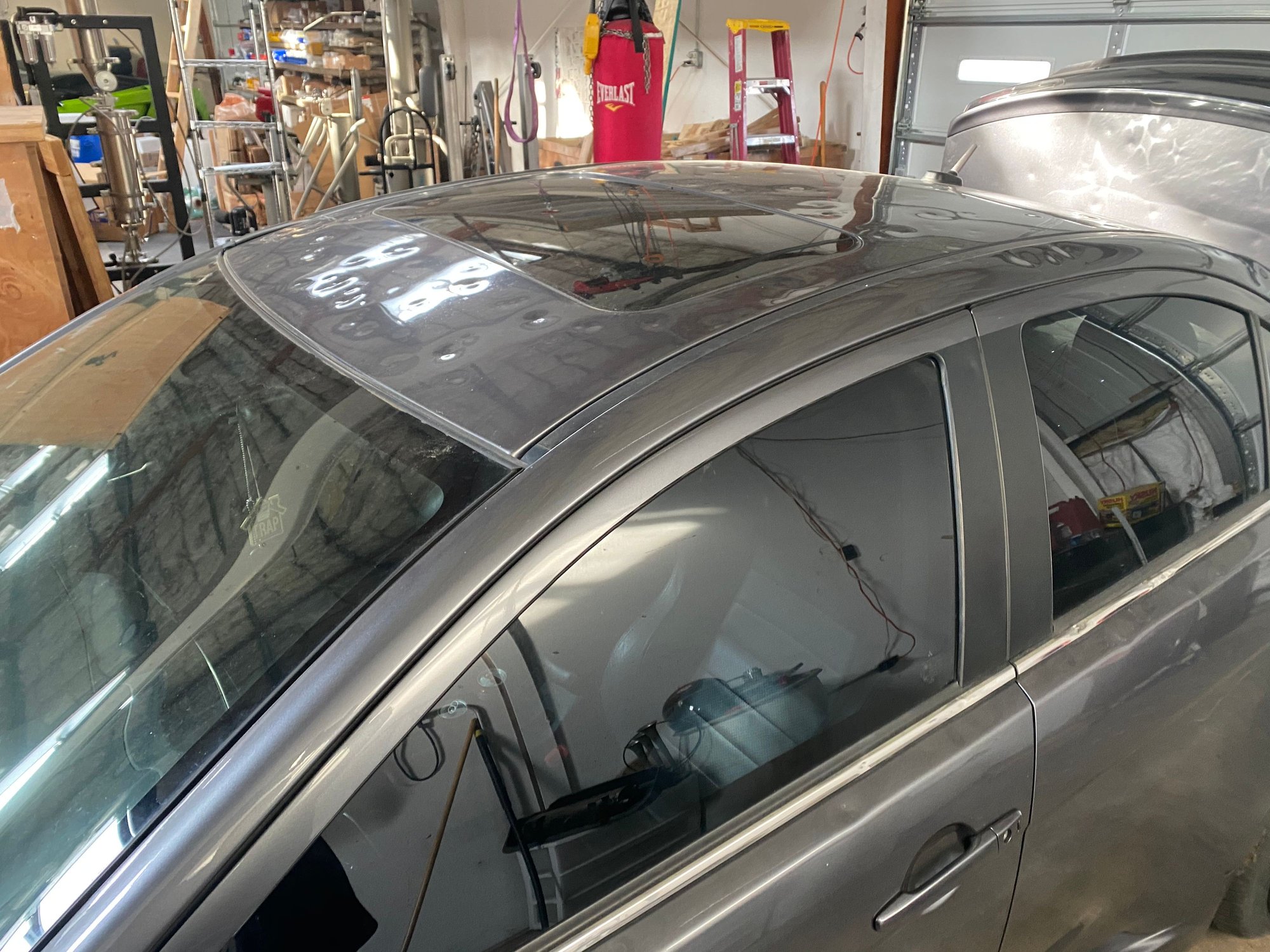

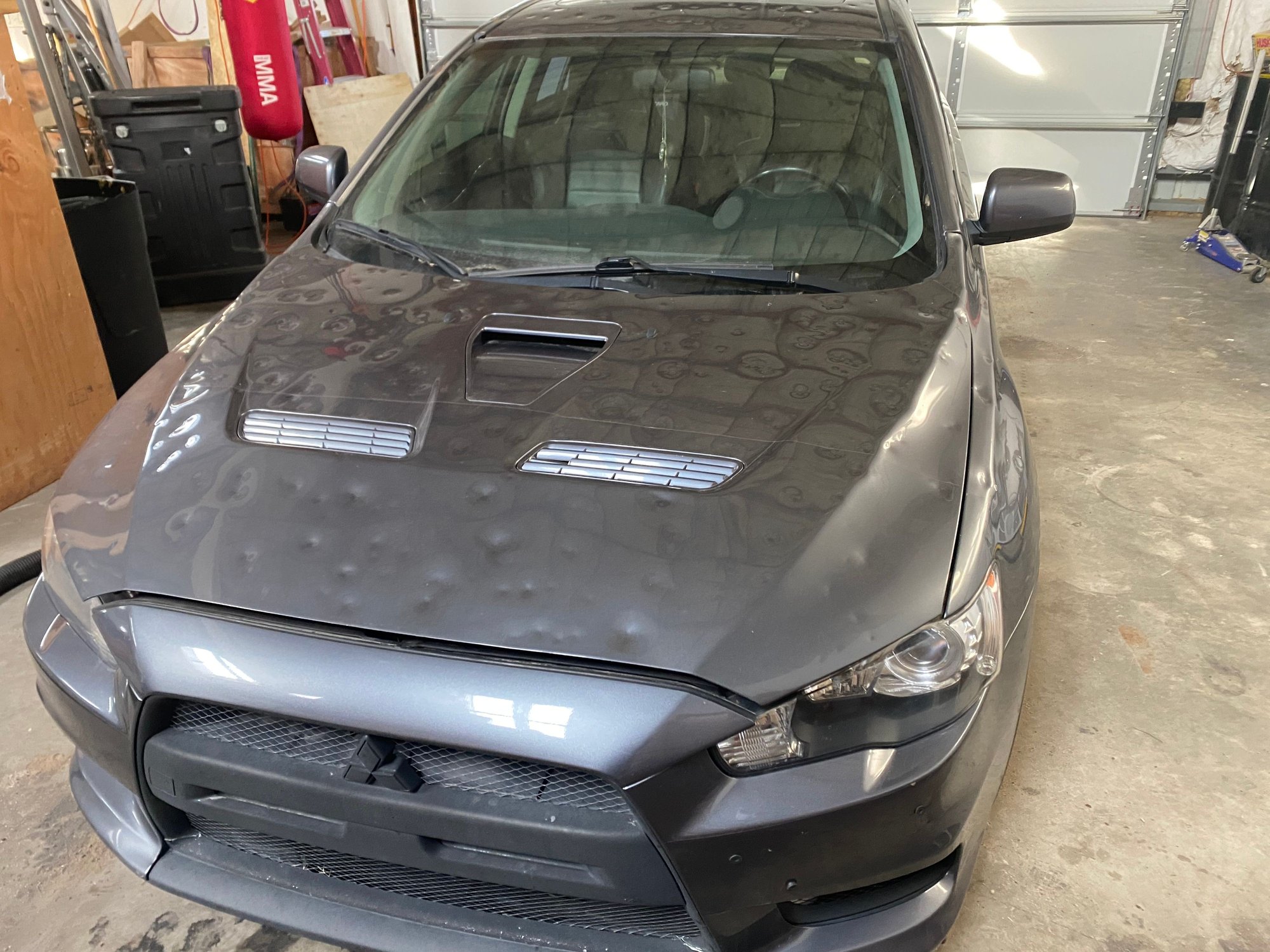

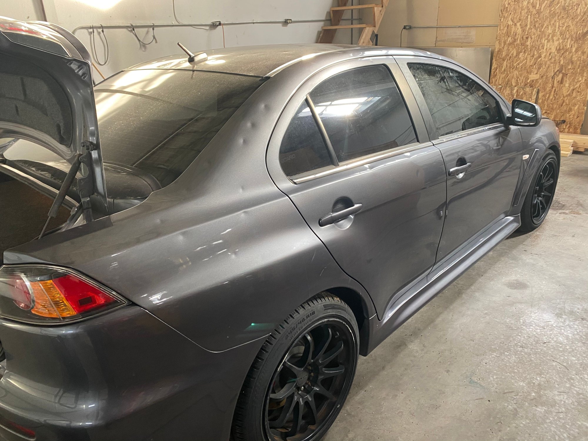

Hey guys,
I’m new to the forum so what’s up EvolutionM world! I have what I think in an incredible deal on an MR Touring but I have no experience with hail damage. The car has 51k miles and is relatively stock (intake, tune, boost controller, and tein coil overs). They are asking $9k. The only (MAJOR) issue is the car was destroyed in a hail storm. I’m going to swap the hood and trunk out for cf but the rest of the car needs major work.
What I’m looking for...
1. Is it a good deal?
2. Money aside, can it even be fixed?
3. If it can be fixed are we thinking paint less dent repair or bondo half the car? If you’ve had experience in this please throw me some sort of estimate. 🙏

Hello and welcome Brian @Brian_E_Spilner
Wow, on that hail damage Looks like a former Texas car?
Cant comment on the deal but for sure the hood, trunk & roof have to go! Not to mention the pillars need body work

Do you think the roof going is a for sure?? I’d imagine that’s a big deal with it being a sunroof

The sunroof equipped Evo X has a steel roof, not aluminum like the non-sunroof equipped version. The skin itself is about $400-$500 cheaper than the aluminum version. Part #5290B033
Trunk lid is also steel (on every Evo X)
Part #5920A097
Hood is aluminum (and expensive new)
Part #5900A244
Fenders are aluminum (also expensive new)
Right side Part #5220C878
Left side Part #5220C877
For the aluminum parts, I would just purchase replacements as they will never look good again. Def don't use bondo on them.
Everything else is steel.

This is going to be truly up to you. Getting it factory fresh will cost you more than you DD budget for sure. Getting close might cost you a few grand which would be appealing as long as little dents/waves in the body aren't going to drive you nuts.
I would send some pics of that roof to the local PDR guys to see if they'll even touch it before I considered buying the car. Getting a body shop to re-skin that roof would be $$$.
You could probably source a roof/trunk/fenders used if you are patient for a solid deal so if you can use on the roof skin/doors/rear fenders, you could get the car to be reasonably straight in your budget.
If you were looking for a good base to build a show or race car, this would be a great deal. As a DD, it's going to be up to your tolerance for having an imperfect car.

That's one heck of a hail storm.
It can definitely be fixed. But to make it look perfect will be tough and expensive. I would aim for a 7/10 for a goal as far as exterior.
I would get a new hood, new trunk, fenders, and let a body shop fill the rest. That might be getting past your budget of 6k though. Finding used parts might not be too bad and save you some $ so start with that route.

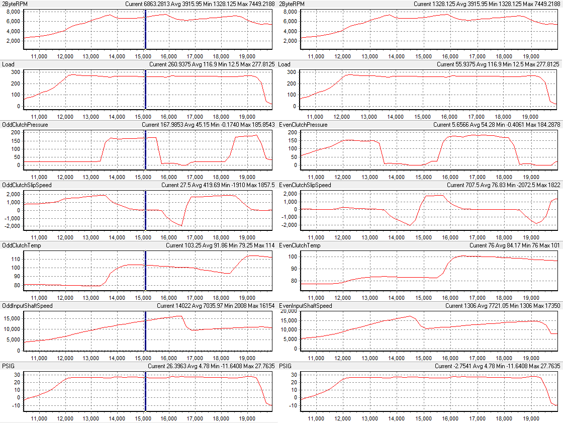

Originally Posted by Warhawker
According to RevWorks in Florida, my car slips the clutch at 300 torque however I disagree. I've cleared the clutch slip codes that were on the car when I bought it, and have since not slipped even in the hardest pulls at 20F ambient air temp. I know I'm probably making around 430whp. My car was originally tuned by AMS to make 510whp on 93 octane. I'll know in a week or so roughly once my cables get in and I get the oil out of my intercooler from that frozen catch can nonsense...
You can easily log your clutch slip and clutch pressures with Evoscan. It also has a lot to do with the tune on the car, as even a stock MR can slip with improper tuning.
Also, talk in torque, not horsepower.

So I had to pass on the hail damaged evo. The roof wAs going to cost me a fortune and it made it not worth it..... but I did buy my fist evo today. Here’s the specs from eBay... Thoughts???
