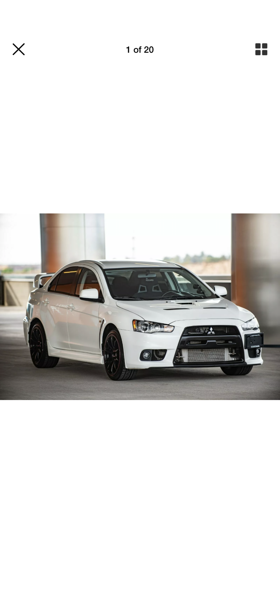

Bought my first Evo! Claiming 800hp ????
Hey guys! I bought my first Evo today sight unseen off EBay for $24,000. Single owner and he had to go back to his country. 78k miles and 5k miles on the built engine. Here’s the listing, let me know what you guys think!
FULLY BUILT 2013 MITSUBISHI EVOLUTION X GSR 800HP (OVER $25K in MODS)
This EVO is comes to you FULLY BUILT from the ground up from UMS Tuning making 800hp on E85. Car has been very well taken care of with a great service history. Super Smooth, Super Powerful, and Super Fun. DON"T miss your chance on owning such a well built and maintained car. Evo has less than 5K miles on full Build, 78k Miles on chassis. Evo comes with:
FULLY BUILT 4B11T 2.0L MOTOR
WISECO PISTONS, MANLEY PRO SERIES RODS
KING MITSUBISHI 4B11T ROD BEARING SET
ATP GTX35R EVOX TURBO
MAP DIRECT FIT TURBO MANIFOLD
ARP HEADSTUD KIT
RADIUM EVOX IN TANK HANGER
RADIUM FUEL FEED, FILTER, AND LINE KIT
WALBRO 450HP PUMP
EXEDY R2 HYPER MULTI DISC
AEM X-SERIES WIDEBAND
AEM X-SERIES BOOST PRESSURE GAUGE
BUILT 5-SPEED TRANSMISSION
EVO 9 REAR END
AFTERMARKET WHEELS
Power Windows
Power Door Locks
CD / Radio
CLEAN CARFAX
CLEAN/CLEAR TITLE
AND MUCH MUCH MORE. .
This Evo could be used as a super fun daily driver or weekend cruiser. Car was built for intention of show quality and craftsmanship and the modifications and reliability speak for itself. Car has never been involved in any accidents and has a perfect and clean carfax.

Welcome, I did something similar not too long ago and built one that was already modified as well.
800HP seems a bit nuts, I would have it tuned and looked over. I'm sure it's on E85 for those numbers, I would recommend a flextune if it does not have one already.

I don't think so with that fuel pump.
I have the same fuel pump, I doubt I could get 800Hp out of it.

Doesn’t make 800. That pump maxes at around mid 600.
Turbo also isn’t capable.

With the Radium hanger, it's possible the setup is 2 Walbro 450s which would get you there......
Odd they don't list cams for a build that big........ Also so many questions! Who build the trans? Was anything done to the rear diff?
All in all, it sounds like someone poured money in to a build and probably ended up with a well built car that just isn't that much fun on the street. Based on the couple of Dyno sheets I've seen for that turbo on an X, you'll probably see full boost around 5000 RPM on that setup.
Even if you hate it, you should be able to swap a more responsive turbo in for a low cost after you offload the big boy. Sounds like you got a great platform to play with!

The CT9A / RA rear end swap is common on higher hp evos as the AYC rear end is a weak point for launching and does weird things on track at higher torque levels.

ewww OEM PCV valve on a high hp build. :-/

Once you start making sustainably more power, the pressure in the crankcase increases because of the cylinder pressure. In order to vent this pressure away from the crankcase, you need larger vents. The OEM PCV on the evo 10 is uber small and barely can support bolt on power. If you don't, you can pressurize the crank case and blow the dip stick (or worse).
Rear end swap shouldn't have any codes if it was done properly (looping the AYC hydraulic lines) and the code from the wheels are because he didn't swap the OEM TPMS sensors to them.

Yea hopefully the guy isn't trying to run different sized tires on the front and rear or anything. The TPMS light could be on due to missing sensors. Maybe the AYC needs to be bled?
Maybe fix the PCV "problem", and take it to a good shop down there in FL for a good look over and possible re-tune? Maybe AWD Motorsports?
