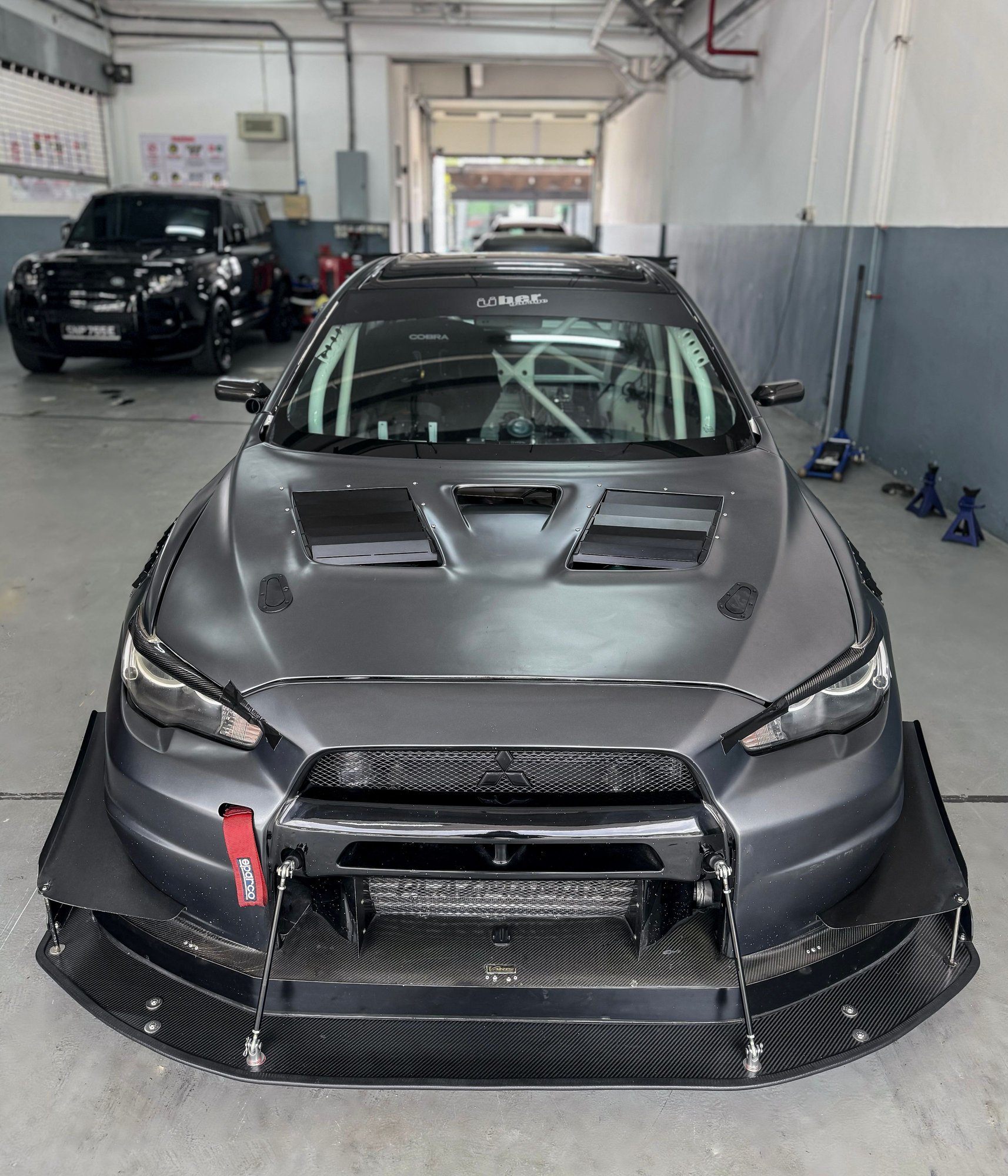

Yeah, it's had A LOT more work done through covid and I am now back at track slowly dialing it in and turning it up.
Haha haven't had chili crab for a few months!
Few other pics of m new brakes etc
ps. I have since lowered the front splitter (as you will notice on the previous pics), trust me when I say 16kg spring rate and splitters 55mm of the ground do not work when braking haha
