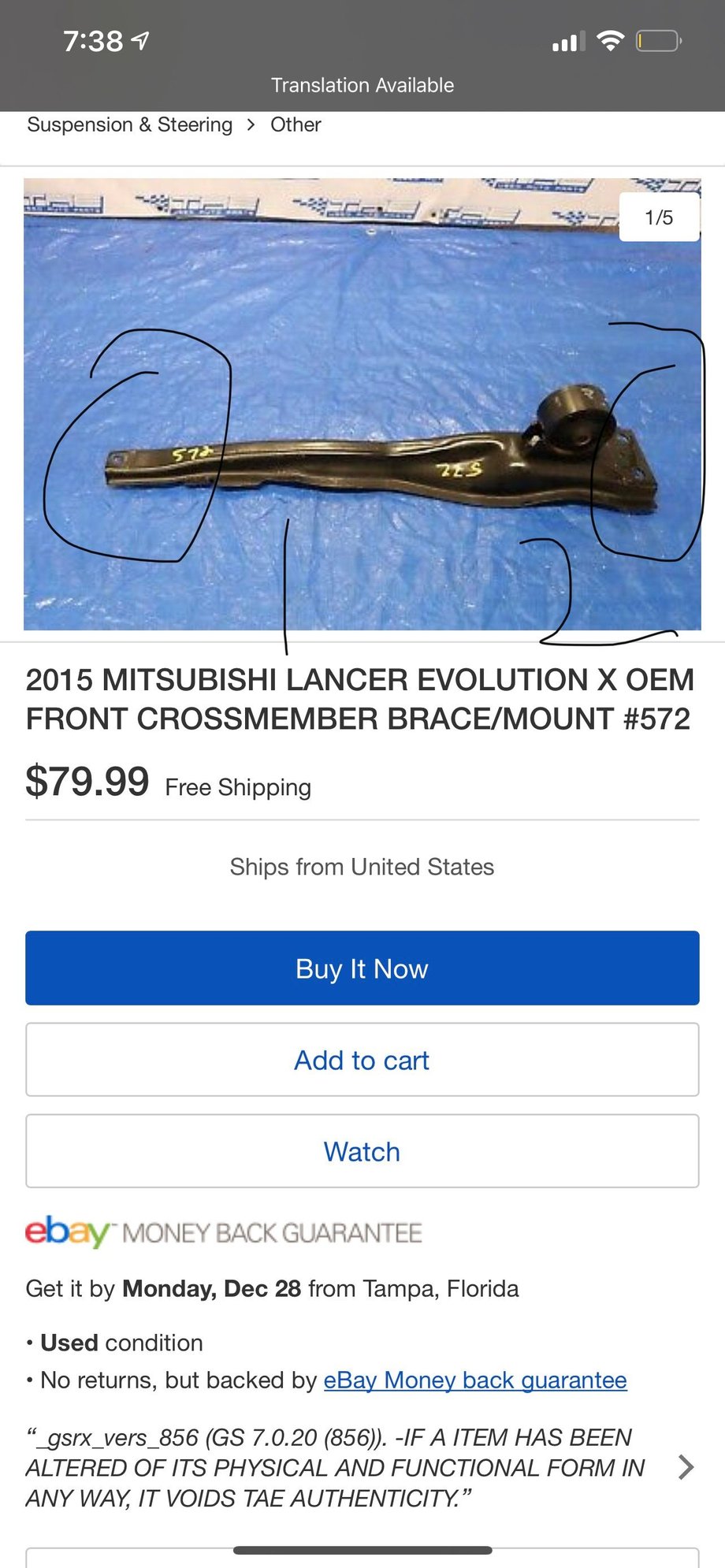

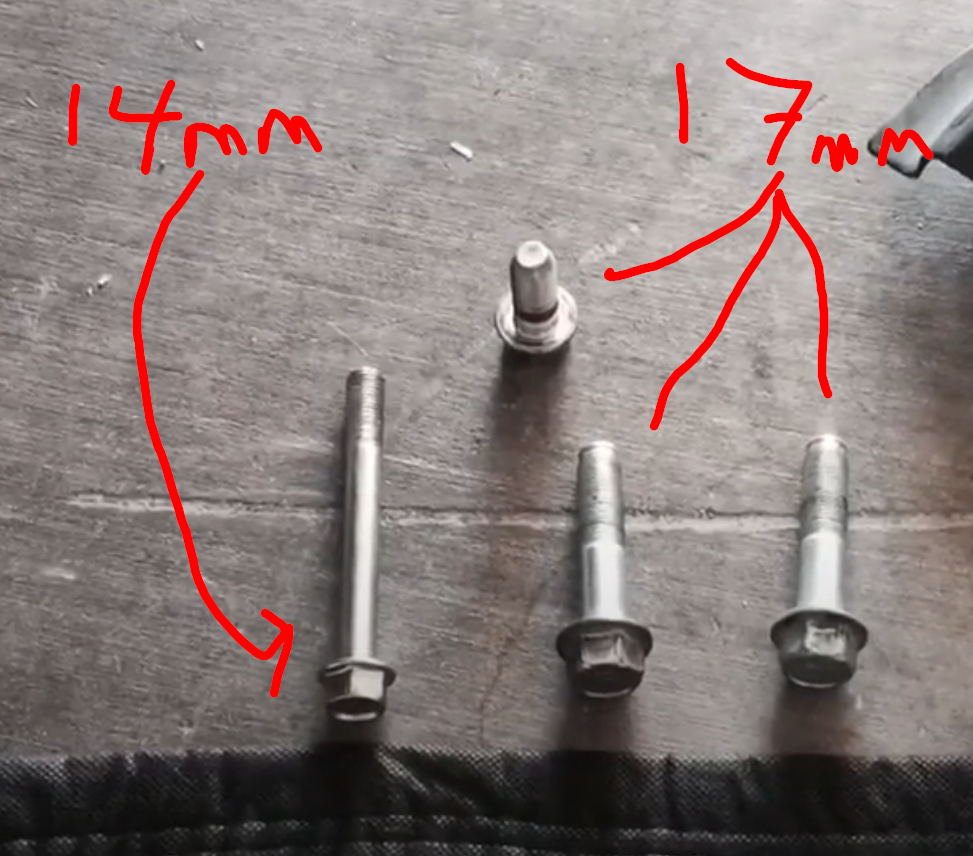

Hello Everyone I been needing some help I been to Mitsubishi they told me those 3 screws that hold the brace up is on back order for 3-4 weeks if I order so I been trying to figure out if any one have the exact size and thread size of those screws? I don’t seem to find them any where and I want to see if I can find it else where before ordering online please and thank you

They're 17mm but I don't know the lengths or the thread pitch. Looks like a fine pitch bolt. Two have a large shoulder and the third is fully threaded. They're pretty specific to the car (flanged head, dog tipped) so I'd recommend waiting to get them from the dealer vs. hitting up Ace/True Value.

Check your local Dodge and Jeep dealers. That part is shared on the Dodge Caliber, and Jeep Compass and Patriot.
I think the part you want is #11 in the diagram on this page:
https://www.dodgeparts.com/v-2007-do...ngine-mounting
If you want upgrade parts, take the bolts to a hardware store and get matching bolts in grade 8 (and might as well get zinc plated too).
