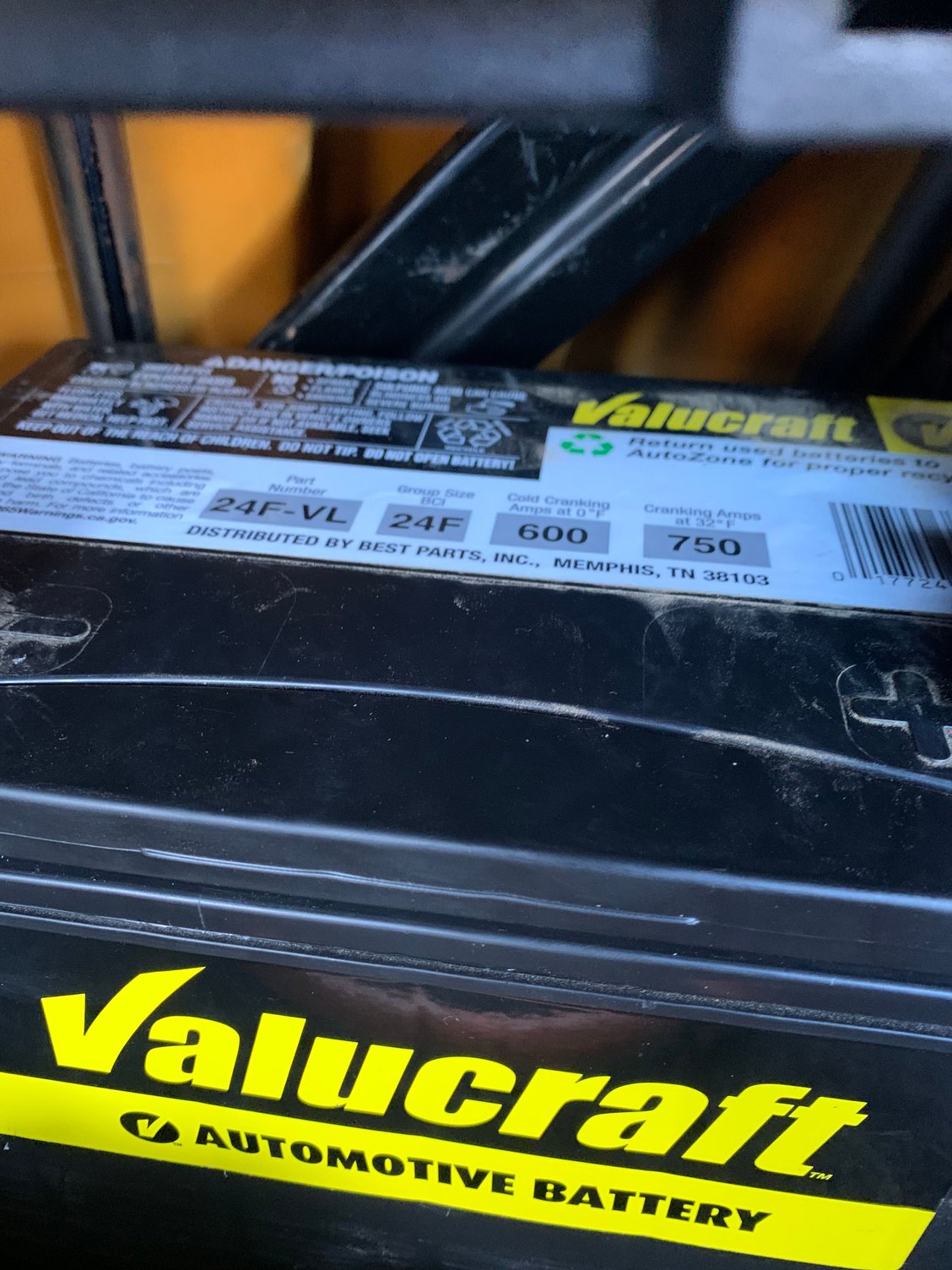

even through the battery is throwing out over 14 volts? You only need 12.6 to start it. That’s the only reason I am confused on why it be the battery. I took it to autozone too and they said it was good. Fully charged and yesterday when it was sunny and the temperature raised up it start right up.
The battery shouldn't be reading that high. It should be 12.x volts with the car not running. If they tested it and it was good ide start checking the electrical terminals for corrosion / looseness
Thanks man, I’ll check the terminals later today. I started looking into batteries and I think the autozone guy gimped me. Couple months ago I needed a battery and he told me this would work so I got it since it was the only thing in stock. Looking through the forum I think most people go with optima or the oddesy battery I may make the buy even though the guy said this would work and it didn’t start giving me any issues until now with the cold weather.

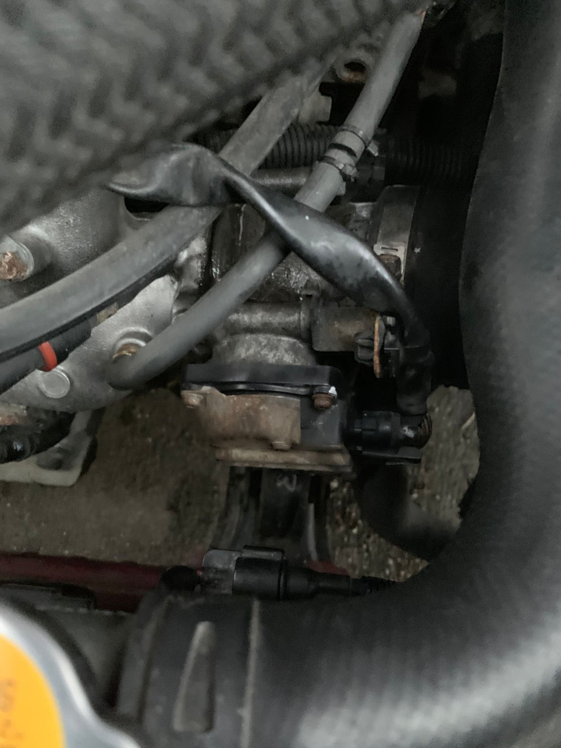

I sprayed starter fluid into the throttle body it started in the cold. Throttle body was extremely dirty.
cleaned up the throttle body. Ordered a new gasket and I’ll be putting it back in tomorrow.
only question I have is do you or anyone know what the sensor on the throttle body is. It doesn’t like the TPS I’ve seen online. Picture below for reference.
