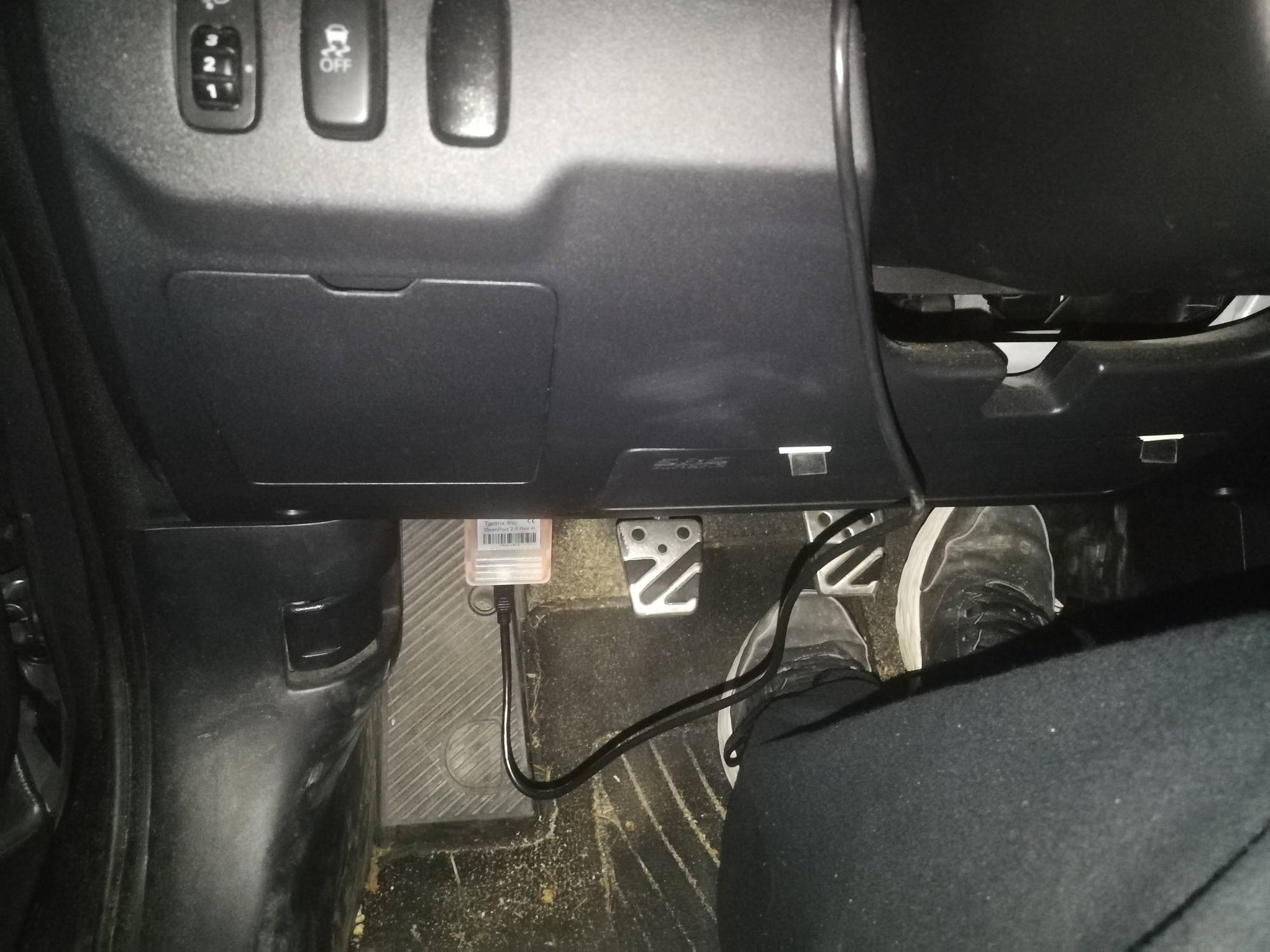

Just got my tactrix cable.

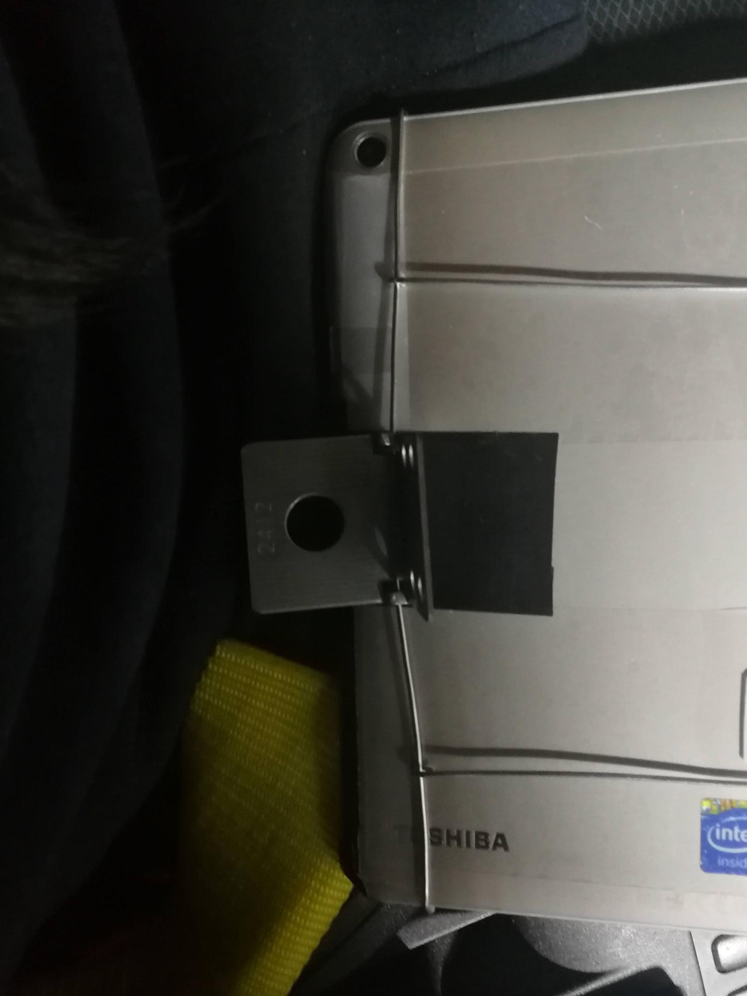

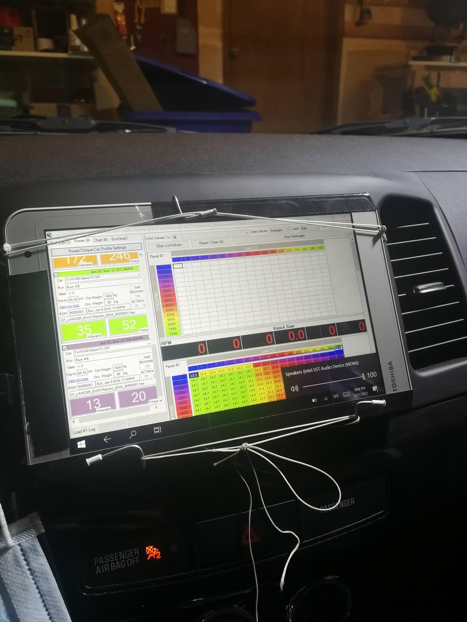

I believe police definitely does not like it, so it's a very temporary setup and can be easily removed but still be reliable during driving. So I used a bracket and some steel wire to build a cage and mount it into the cd player with the help of some rope.

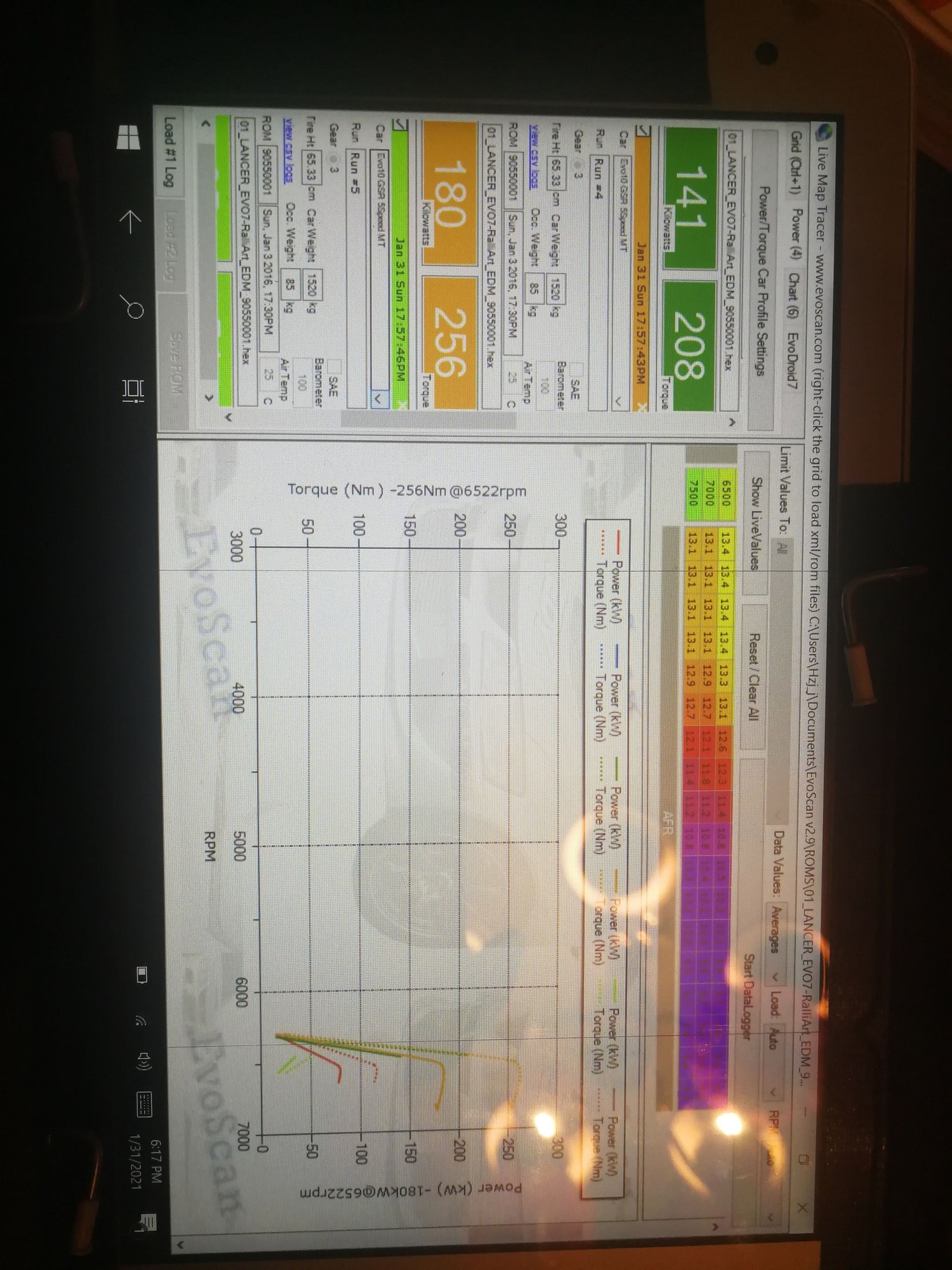

It works as expected with evoscan.
A windows 8 tablet is actually very useful here, it's full windows 10, has usb host, touch screen, can be charged by micro usb - literally same as phones. And the most important thing is, they are built around 2014, matches my 14.

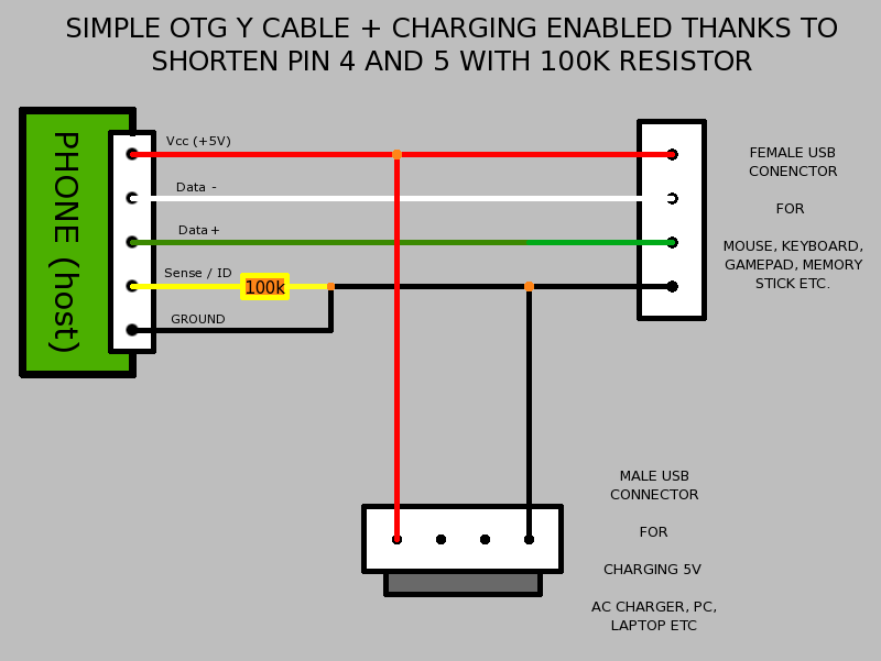

I am working on a otg cable with charging, most of them on ebay won't work at all. I have got something like this:
But a 5 pin micro usb port is slightly hard to find. Most charging cables require 4 pins only, common otg cables short circuited 4/5 pins directly.
