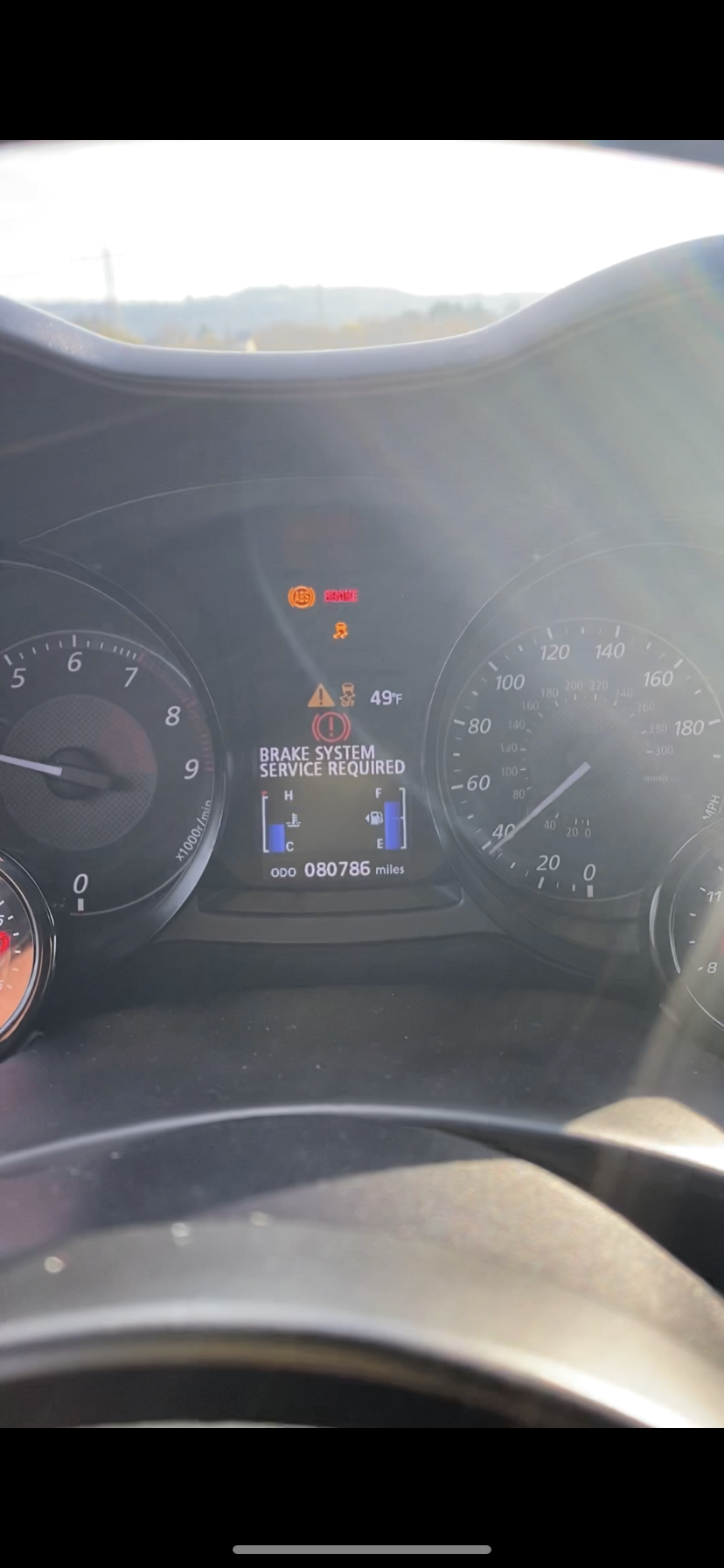

Hey guys, I was driving home today and every time I stepped on the throttle a bit (2k to 4K) all those lights would come on and sometimes I would lose electrical power to the dashboard (it would come back on immediately) this also happened when making turns.
Any ideas ?

Ground connection? First thought was wheel speed, but that wouldn't explain loss of power to cluster.

Yes the ground cable on the battery was barely touching the terminal, so every time I did a hard pull or sharp turn, it would come off and create a voltage drop.
