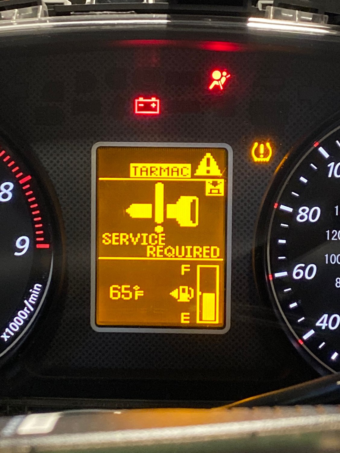

I ran the OBDII scanner, and it came back with no codes. I noticed that once I connect the battery and turn the key to the ON position, the Service Engine Soon light comes on, and then clears after about 10 seconds. So I guess there are no CEL codes. I also took a picture of the Service Required thing that keeps popping up in the dash, along with the hood open and door open warnings but I assume those two warnings wouldn't cause a no start condition.. but the key may???
