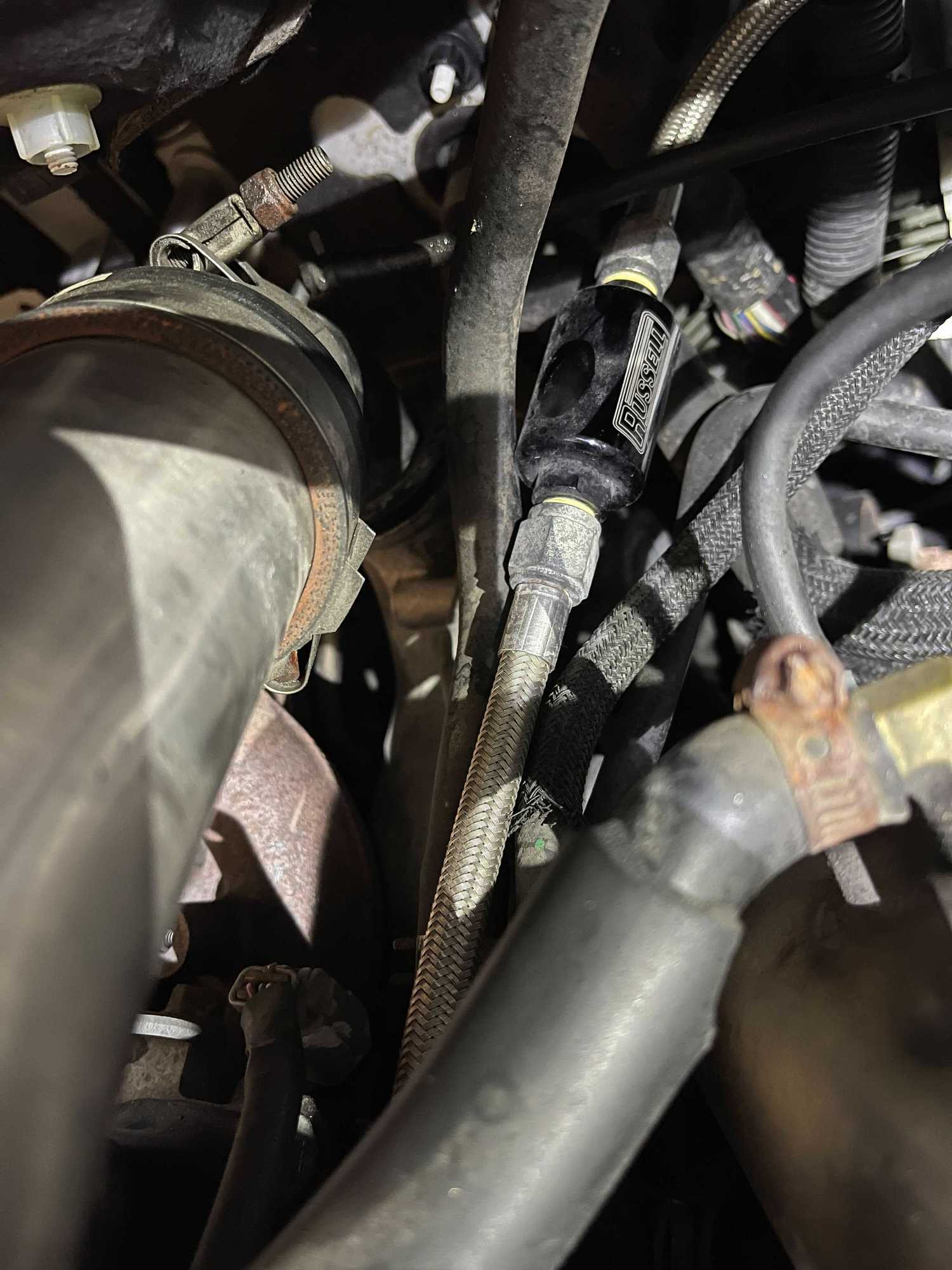

First I'll run through what I can identify it has for aftermarket items. Looks like an aftermarket intercooler and hard pipes. EMS intake and a full catless exhaust. It also has a Cobb Access port V3 but the interface says its not running a map currently. Thats what I'm able to clearly identify for parts. However, when inspecting some vacuum lines last night, it looked like the injector harness has splice points which makes me think it may have different injectors as well. I will provide a picture. Also, the fuel line in the engine bay has a braided AN section with a Russell 40 micron filter inline which appears to not be factory from what research I've done.
