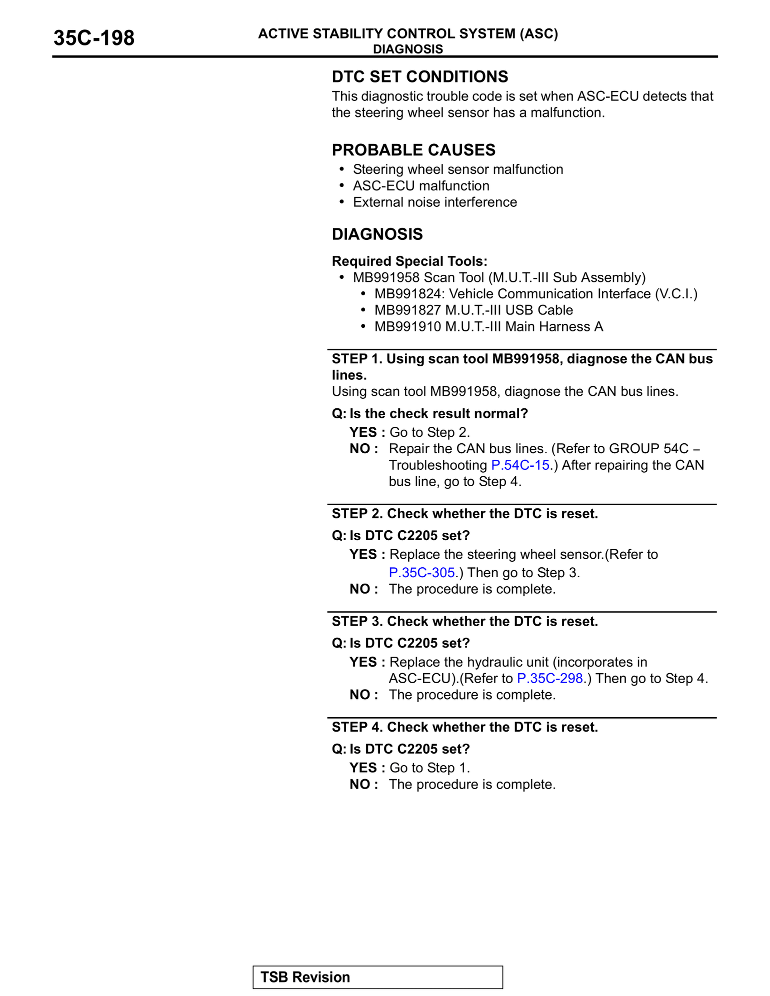

From the manual:

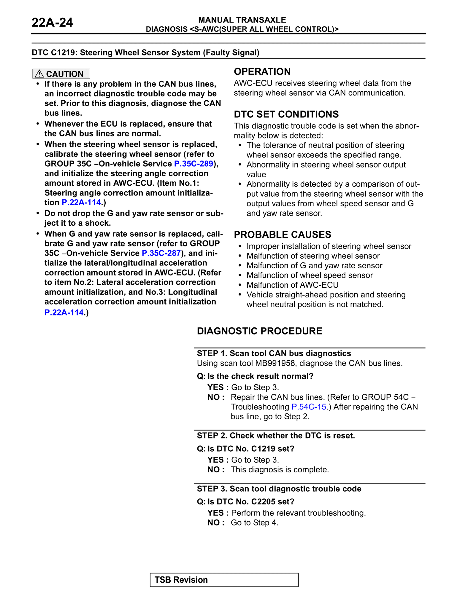

Old Oct 11, 2022 | 03:58 PM

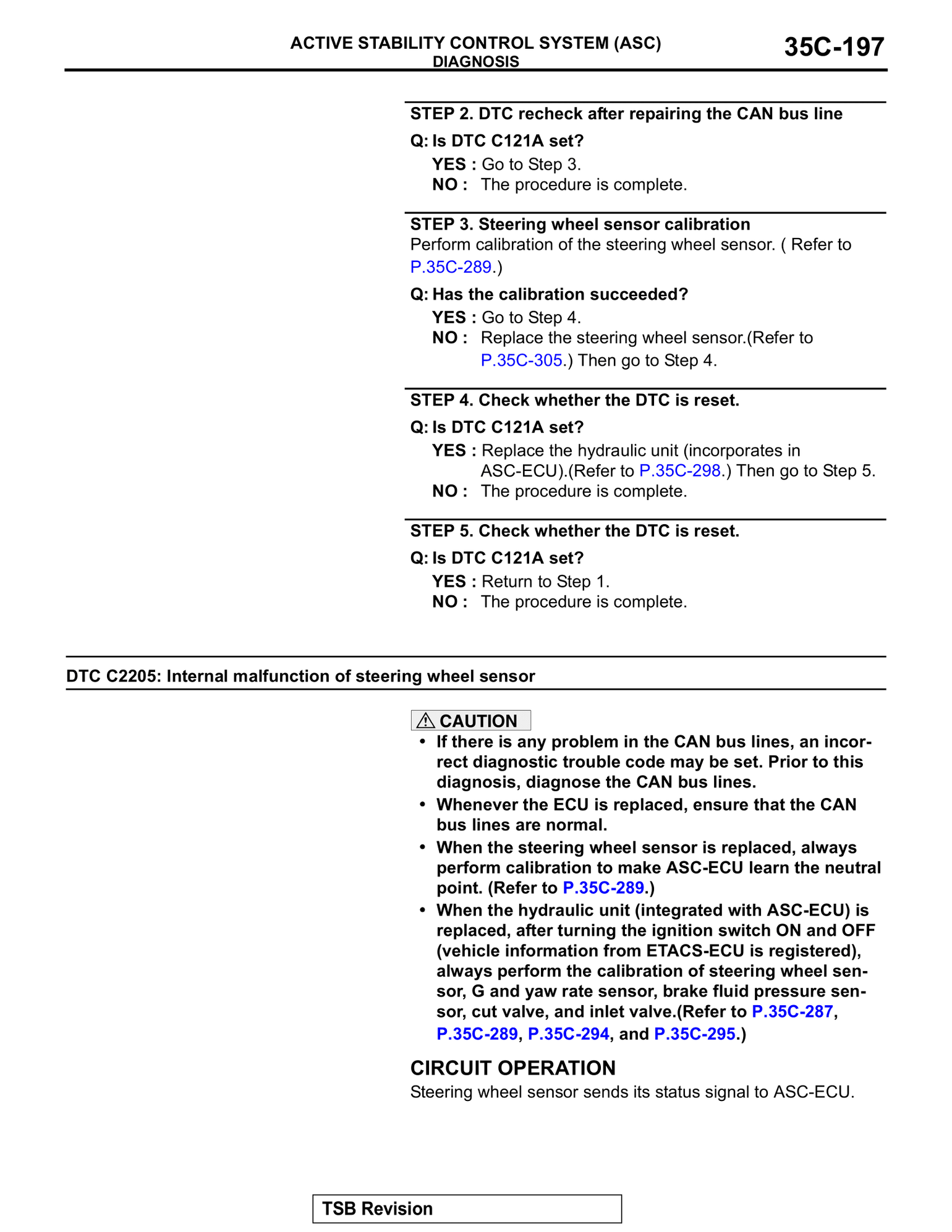

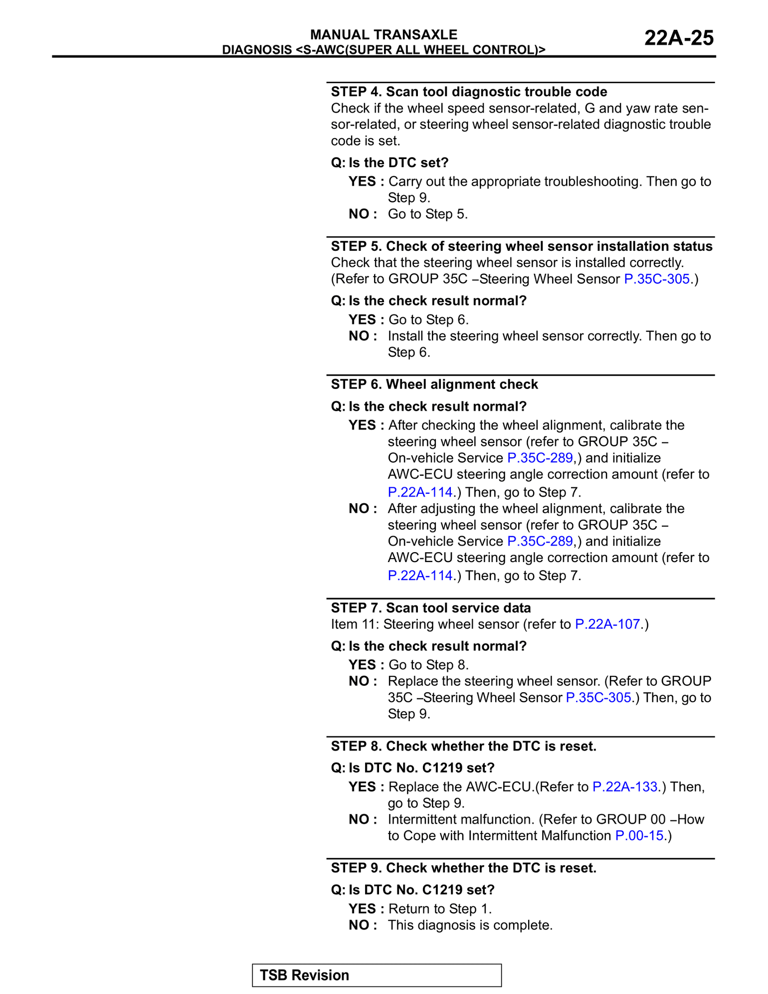

Old Oct 11, 2022 | 04:00 PM

You can grab the manual here:
https://evoscan.com/tech-articles/#Manuals
