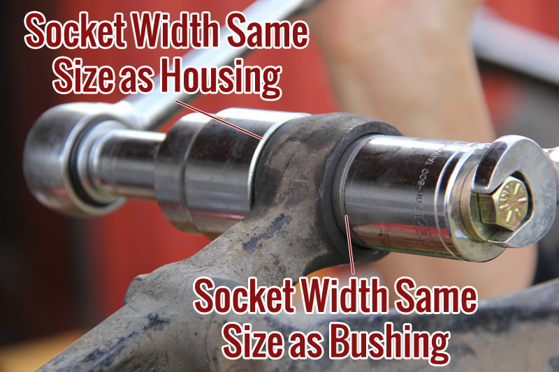

A big socket that matches the outer bushing sleeve and a bolt/threaded rod can pull it in. Otherwise you can try to get your hands on a bushing install kit.

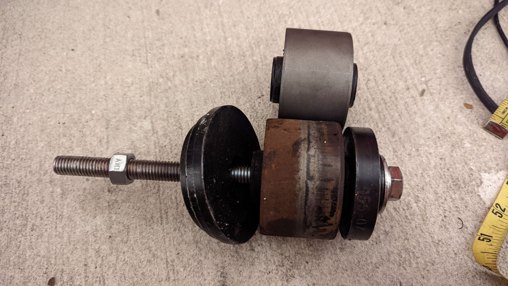

I used a makeshift tool similar to posted above using pieces from my bearing remover tool kit and a long *** threaded bolt from home depot. The service manual says to press out from the front side pushing towards the rear and install from rear pushing towards the front.
Note: I also used a sleeve that went along with the bigger piece on the left that allowed space for the bushing to press out. Did this opposite to install new Ralliart Group N bushing.

I'd imagine that the folks who used an air hammer probably did it from the rear hammering forwards, unless they dropped the diff completely. But if you make the tool, it's a super simple process and comes out with relative ease. Honestly it took me longer to put together the tool than it did to press it out.

I had to remove the side mounts as well to allow it to move down and slightly to the left to allow enough room.
