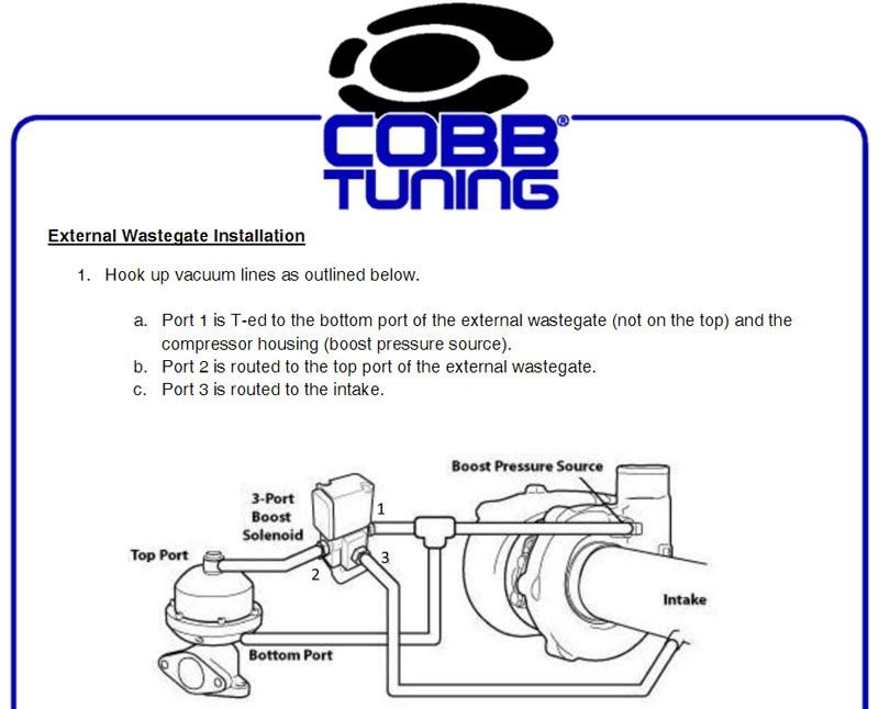

You can install the 3 port and leave it unplugged. It'll have the CEL, but it'll be running wastegate boost and won't hurt anything.
Which hose should be unplugged to keep the wastegate always open? The hose on port 3 (intake vacuum)? The hose on port 1 (boost source)? Or all 3 of the hoses?

Removing the hoses to the wastegate will have it running whatever pressure the spring can accommodate and no more. To have it always open on an external gate you'd have to remove the spring from inside, which might have other consequences. The nice thing about an internally gated turbo is you can disconnect the actuator arm from the flapper valve and it just stays in bypass.

The Evo X's stock TD05 turbo has an internal wastegate indeed. So I guess if the owner unplugs Port 1 (boost source), the wastegate actuator will remain at its default position?

I think what he meant by leave it unplugged is the electrical part of the controller not the hoses. You must absolutely connect the 3 port hoses, All 3 on an MR. Do not vent it. With the solenoid unplugged, it will only hit wastegate spring pressure which is about 12psi. So less than stock. You will be fine to drive it if you take it easy.
A 3 port solenoid (AEM, Grimmspeed, Cobb, any MAC35 based valve) is naturally in the open position. Meaning air will travel through it as if it was just any normal hose. It doesn't actually "increase" boost until you apply electrical pulses to quickly shut and open the valve. Therefore by hooking it up and LEAVING IT UNPLUGGED you'll hit a max of 12ish PSI, but you will have a check engine light for the solenoid not being present. No problem, drive it lightly, oncer you get there plug it in and hand them the keys.
Problem solved.
