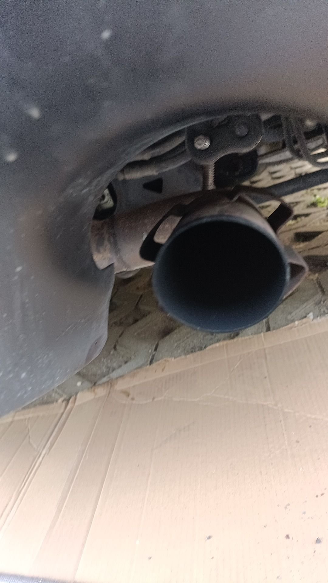

hello guys, i'm writing in general because i can't find a thread about It;
can Someone help me to remove the OEM evo X tips?

Never removed them myself but there are a couple of rivets in the bottom and the tip is crimped together along the bottom as well. I'd be willing to bet there are a couple of spot or resistance welds on each of the 4 inner support points as well. If you really want them off, I'd suggest you get a cutoff wheel, a grinder, and take the muffler off the car to get the access you'll need to take it all down.

Thanks buddy, yes i found out Yesterday how to remove them and i did It
