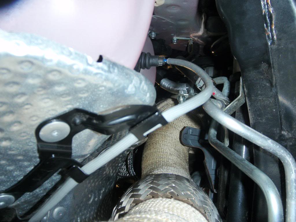

These photos are not related to the down pipe install. However, since I did the full exhaust at the same time, and I am sure many people do the same, I have included these photos.
Here is a picture of my test pipe with the heat wrap installed. The reason for wrapping it is two fold. Fist, to keep heat down under the car, and second, to keep the heat up inside the test pipe to reduce chances of CEL. This particular car has a COBB stage2, so the CEL is not an issue. Heat is. Yes, this stuff really works.
O2 sensor bracket on factory cat. I used this same bracket on the test pipe.
Here is the O2 bracket installed on the test pipe. I guess its a good ground floor view of the exhaust installation. Note that the car is barely 24" off the ground. It would not seem like it, but this is actually a pretty good height to work at without a creeper.
Here is the view from the cat aft.

Rear view of exhaust installed.
Parts that won't be re-installed.
Totally off topic picture of some of my other toys cause I think I'm done with this post. Finally. The car is an 2003 and 100% stock. The bike is an 81 wide glide with a 93" stroker, ported and flow matched heads, S&S B series carb. Very old school. Also very fast for a new HD, let alone an old shovel.
