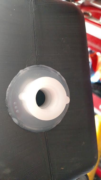

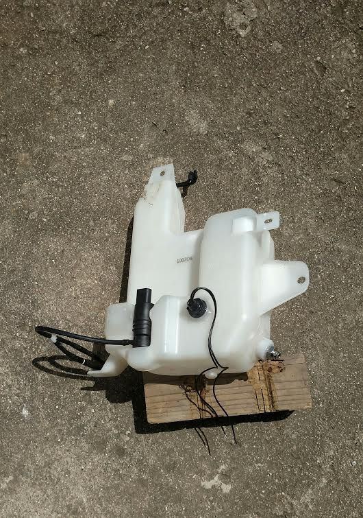

To be honest, with a kit billed as EVO X specific I sorta thought they would have incorporated the rear mounted washer fluid reservoir. I mean it doesn't take much imagination to realize it was set up for more than bug juice. A.k.a. IC sprayer, Methanol Tank, and etc. Oh well, with some careful razor blade surgery I was able to remove the plastic pipe fitting from the shipped three quart tank and glue it to the Mitsubishi tank and plumb it for a level float as well.
