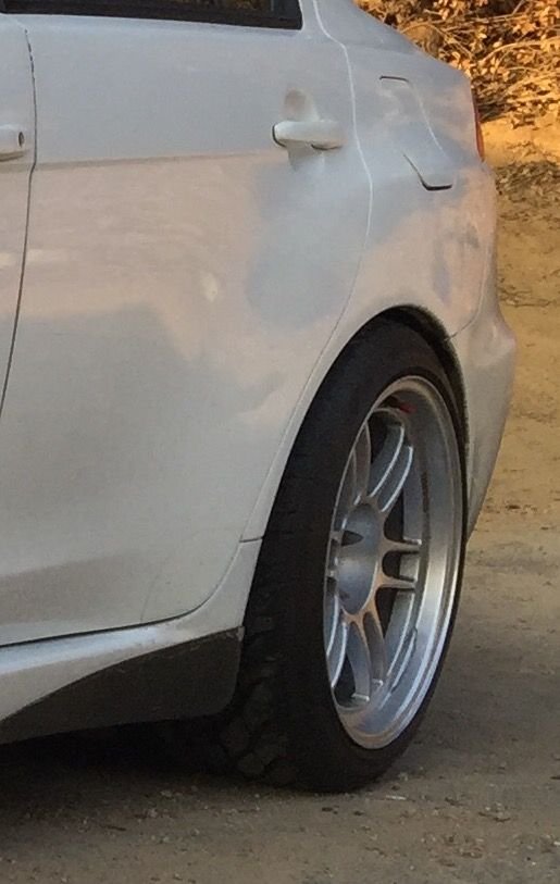

19 x 10 +22 Enkei RPF1s
275/30/19 Michelin Pilot A/S 3+
Tein streetflex coilovers
1 degree of camber all the way around
Fenders rolled pulled, no fender liners, no undertray

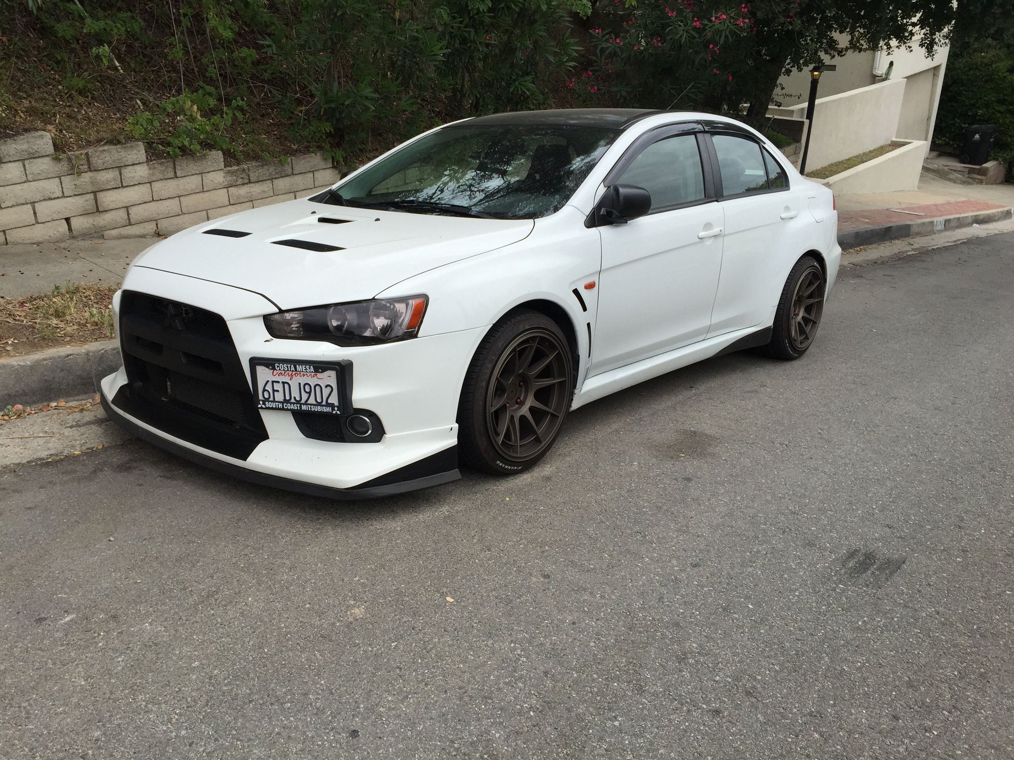

I wouldn't say mine are deep dish but they are 5 spoke, you can use as reference
Advan GT MHB
19x10.5 +25 all they way around
rear fenders rolled (front not needed)

WOW. This is exactly what I'm looking for. 10.5 inch is massive, didn't think they would fit.... What size are your tires? No spacers needed at all?
Just want to make sure before I bite the bullet.

Very clean and tasteful car Stevo-X
Makes me miss my white X.

Seems like 9.5 - 10.5 width is the way to go on these cars, you would have to see what wheel you wanted either 18" or 19" as some don't clear brakes without spacers. I was lucky enough that the Advan's were "made for big brake kits" because of spoke design. I too was going to go with the SSR SP4 but the way they have their disk setups were weird to me. If I wanted to go that route I would have had to get the High pad disk in 19" because of the step lip. As for tires, they are a bit stretched at 275-30-19. I probably could have gotten away with 285 with a full roll in the rear and heat molding the fender liners, but I'm lazy and didn't want to do that. I also didn't want to buy spacers, I would say I have about 3-4mm of clearance between the back of the spoke and the caliper. Just research the wheel you want cause all of them are different.
Seems to me like the popular offset is +15 - +25 ish.
