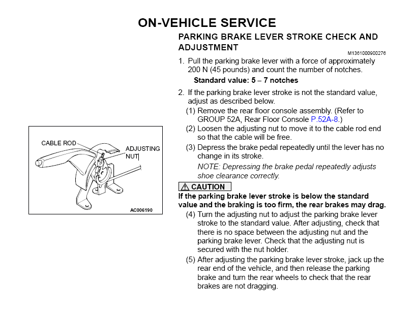

Old Jan 15, 2010 | 05:40 PM
revvin9k's Avatar
iTrader: (23)
Posts: 2,315
From: IL
Grabbed this from another thread.... ( this is for the wrong chassis, but how much could have changed?)
this shows the adjustment for the e brake inside the cabin. I have only adjusted mine from the rear rotors and have never had an issue. This method would work as it would be faster and easier (questionable) just to get it tight again.
Sorry for any confusion I may have induced into this thread.
