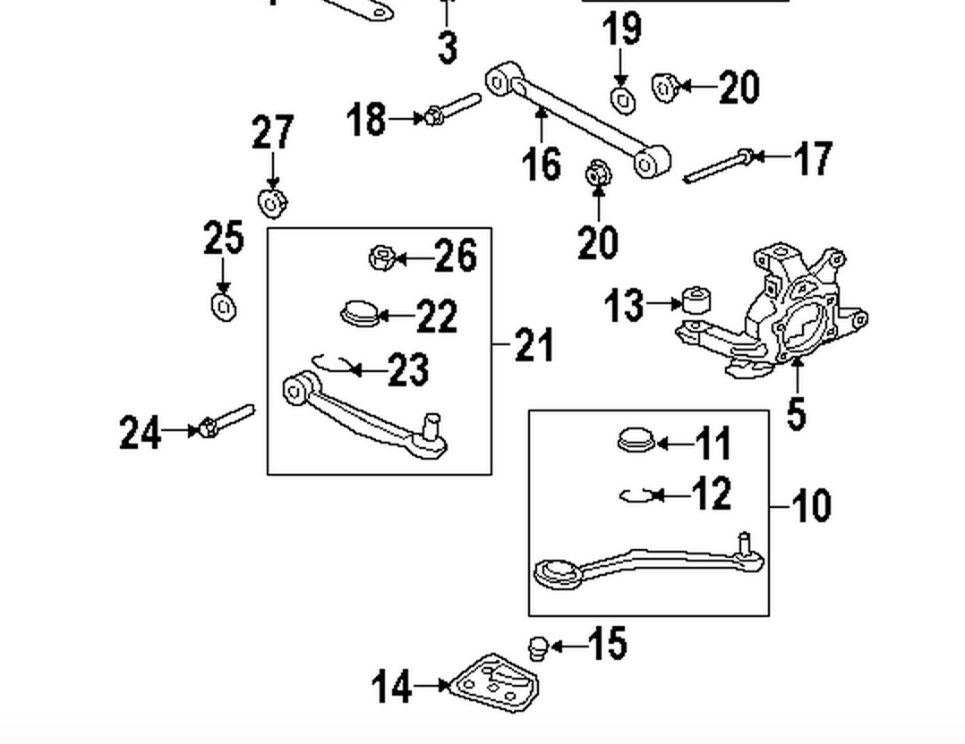

I think I will need 18,19,24,25. What's the #17? Is that a eccentric bolt?

18 and 24 should be eccentric bolts. 17 is a normal bolt. Turns out to be the same part numbers.
17 : MR491305
18 : 4117A018
19 : MN184102
20 : MU000763
24: 4117A018
25: MN184102
27: MU000763

So the 18 and 24 should be the camber bolt and toe bolt which are used for the alignment. Is it correct? The part 17 normal bolt is not related to any alignment stuff?

Yes 18 and 24 are used for alignment along with the plates.
17 is a normal bolt not related to alignment.
