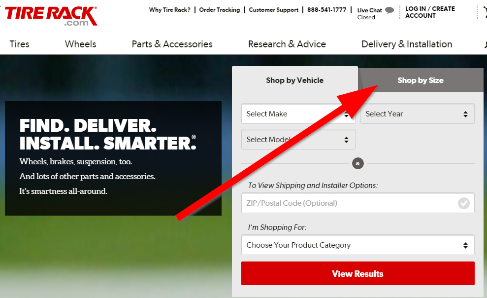

Hey folks,
I searched around the forum but didn't see an easy way to browse through tirerack to view larger size wheel/tire combos for my 08 X. Any suggestions?

From the main page just click shop by size. You'll want to know what size you're looking for, of course. But otherwise, it's easy.

Yes got that,but can't size anything above 18x8.5 unless I'm not correct when I browse doing that. I can search a 18x9.5 +22 wheel and tire combo without entering a vechile.

Gotcha. So I can pick "shop for wheels" and if I choose 18", I have a ton of 18x8.5 and 8 18x9.5 tires. However, when I go to tires I only get 245/40/18 as a size option. I don't think they're willing to guarantee fitment of anything bigger so you're just going to have to order wheels and then order tires and not use the combo feature.
