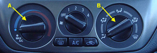

OK, this is very simple, don't worry! Look carefully at the attached picture, and follow these instructions:
1. Firmly grasp temp. knob "A" and pull it off. This may be easier than normal because you broke it!
2. Remove vent knob "B" in a similar manner and put it in knob A's previous location.
3. Go drink a beer because you have a functioning temp. knob.
And a broken vent selector knob? Good one.
