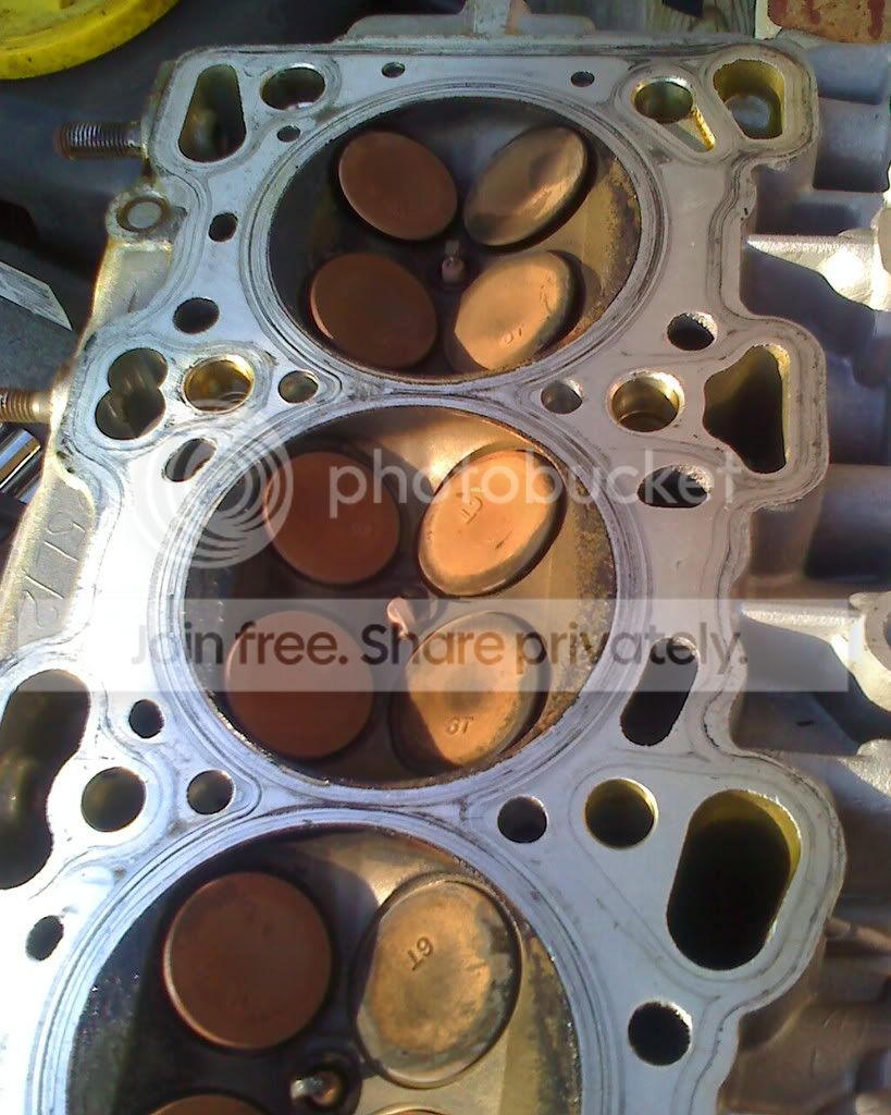

Originally Posted by biggie5252
As promised, I would humbly let you know I messed up. The cam install went great. It was actually a lot easier and quicker than what I expected. Here's where it went wrong . . . I decided I was going to install some headstuds at the same time. Well, I untorqued one of the bolts a couple turns and then decided, no I'd rather watch the superbowl. So I started to retorque it. After a turn or so it didn't feel like it was tightening and then by the time I could say to myself something wasn't right it snapped. So I pulled the head and luckily got the bolt out no problem. Now I'm just waiting on gaskets to get here. Here's some pics.
http://i249.photobucket.com/albums/g.../moto_0047.jpg
http://i249.photobucket.com/albums/g.../moto_0044.jpg
http://i249.photobucket.com/albums/g.../moto_0046.jpg
http://i249.photobucket.com/albums/g.../moto_0050.jpg - A headless Evo!!
The pics of the head and cylinders was for someone to chime in about the coloring, and if there's some way to clean it and any other suggestions while the car is apart. It's had crap gas back home and some octane booster for the last 6 months while I was on deployment. I'm assuming that is part of the reason for the orange coloring.
GO GO Gadget flamesuit!!! Equip I told you so shield; Level up humility . . .
It looks like you need to change your plugs. Just thought I would mention it.

Yeah I have new plugs. That crap looks horrible. I got it cleaned up pretty nicely though. I get my gaskets today and should have it back together tomorrow. I'm on duty today and I'm going to do some other things while the car is apart. Nice weather FTW!
