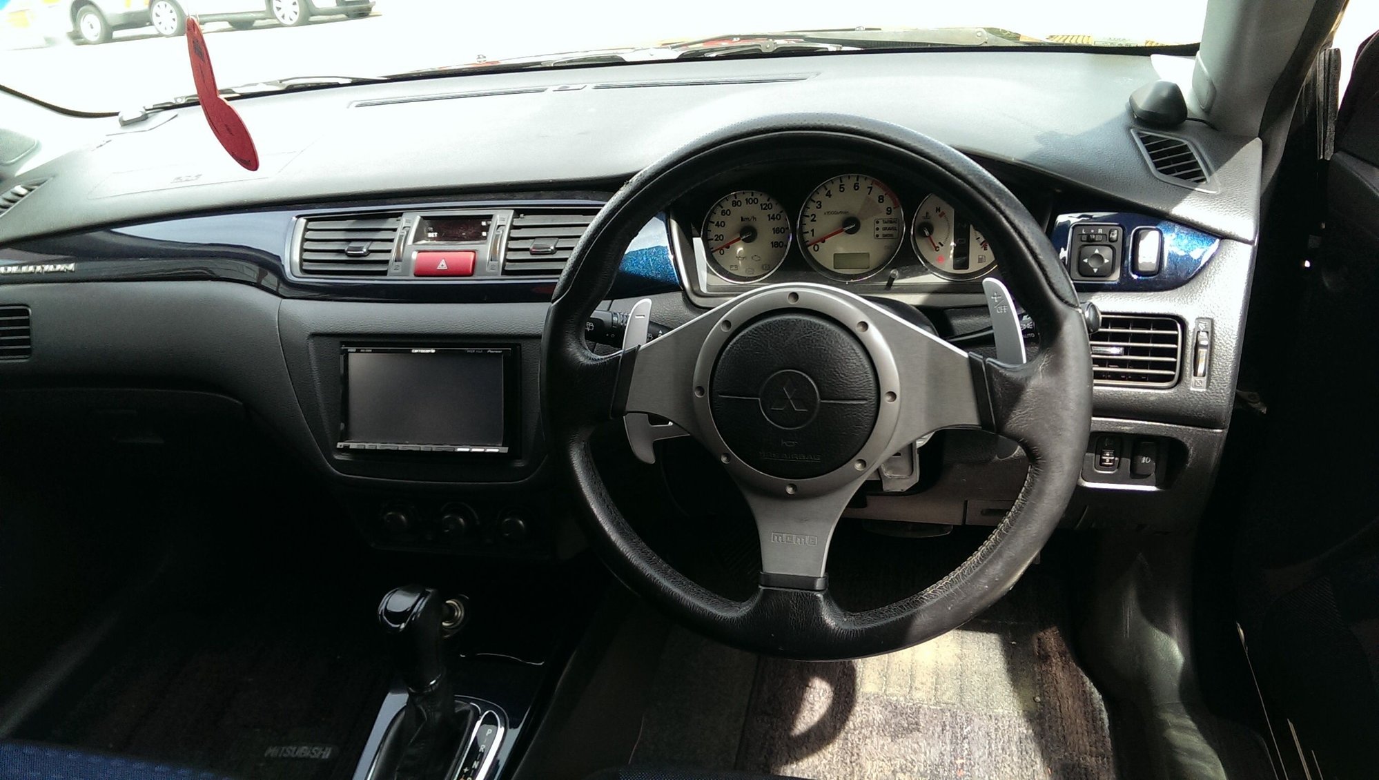

Old Jul 6, 2016 | 04:05 AM
  #38
jmn17's Avatar
Joined: Jan 2015
Posts: 10
From: Australia
Looks good, I've still got the stock steering wheel so there isn't that much space between the paddles and the wheel. Looks like the momo fits better.
Old Jul 6, 2016 | 05:22 AM
  #39
Djcontrol's Avatar
Joined: Mar 2016
Posts: 2
From: Essex
I just bought a second Gand one from the bay,definitely looks better and more space,I did have to butcher the cowling though,but I bought an evo x one and used the bottom part with the standard top one..I then clamped it and was ok
