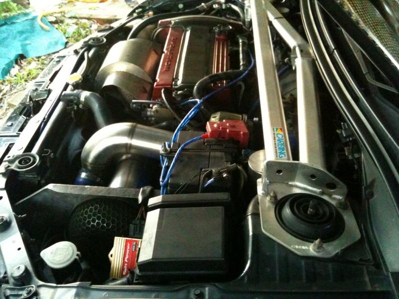

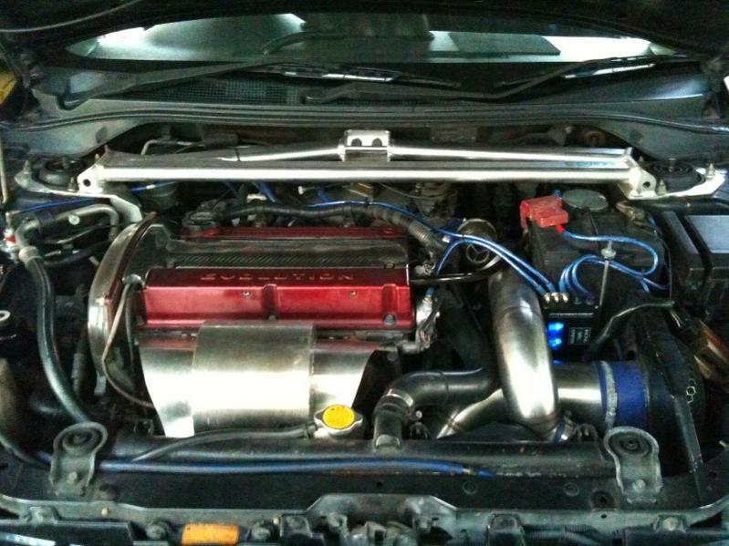

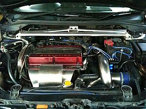

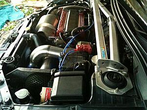

can u guys identify this mod for me?

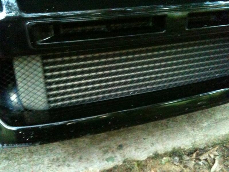

how about this one?
and it got power enterprise 255 fuel pump
Q45 throttle body
greddy turbo t67-25g
Attached Thumbnails need help plsss-intercooler.jpg   need help plsss-gauge.jpg   need help plsss-bov.jpg

Originally Posted by evo7black
anyone can tell?
can tell what? what are you asking? all you did is load pics of ur engine bay! yes we see all the mods=cool but that doesnt really have ? or answer that deals with ur problem....
if you want a super easy way to check for a vaumm leak go to your local parts house and buy a can of flamable brake cleaner and while your car is idling spray it around the engine if it idles up then you know you have a leak!!!!I would spend most of my attention in the intake manifold area....
