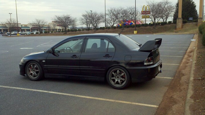

Hey guys I'm new to the site. I purchased my first Evo about 3 days ago. Its an '05 TB.
Engine mods for now are: Perrin Intake, Turbo back exhaust, AMS FMIC and Lower piping and a manual boost contoller.
I do not yet have a boost gauge or a wideband but I will have them in the next couple weeks. (So I don't really know how much boost I'm running)
When I test drove the car it drove great, very smooth. It was pretty quick but I didn't really get into it much over 5k rpm. When I was checking the interior out I opened the glove box and I saw two wires sticking out, 1 said IN and the other said OUT. There was also a red button that was illuminated in there and when I asked the dealership I purchased from they said the button may be used to switch between different fuel maps and that the ecu may be aftermarket. The car drove great so I made the purchase.

congrats and welcome to the forum
car looks good, some better pics might help
any more plans for it?

Thanks for the welcome. I'll try to post up some better pics tomorrow, we've had some crappy weather here lately. And as for plans for the car i'm currently looking for a IX turbo and bov, cams will come this summer. My ultimate goal for it is e85, built 2.0 and an fp red or black. That'll probably happen next year around tax time

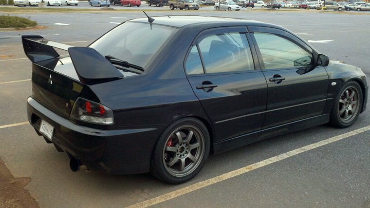

Newest Pics
I know i need tint lol.
